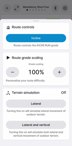

Terrain simulation mode
Terrain simulation mode is setting that can be toggled on for a run session in the Wahoo app to enable semi-randomized vertical and lateral (left-right) pitch changes of the deck at .5 degree increments at 10 second intervals before the RUN is used without an app/device, with the Wahoo app, or with a third party app or device.  Terrain simulation mode is designed [1] to reduce the fatigue of repetitive motion caused by foot contact at the same angle of the treadmill deck and [2] to simulate the experience of varied surfaces when running outdoors.  For more information, see Terrain simulation mode [RUN].

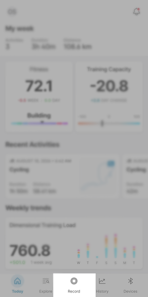

  1. Navigate to the Record tab at the bottom of the main page

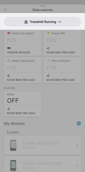

  2. A Data sources panel will pop up, showing potentially connected devices
  3. From the drop-down menu located at the top this panel, select Treadmill Running.
  4. Close the Data sources panel by selecting the X or swiping down from the top of the screen.

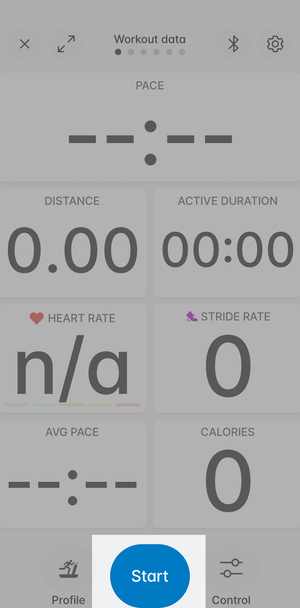

  5. Select the Start button, and your phone/tablet will display and record data from the treadmill.
  6. Start your run on the KICKR RUN.

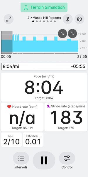

Structured workouts, often also called "planned workouts", can be loaded into an app to to automatically control the KICKR RUN’s belt speed and deck grade (if grade changes are prescribed in the workout) according to the changing intervals in the workout. As a matter of safety, changes to the belt speed at an interval change point must be confirmed using the speed paddle, ensuring that you are aware of the belt speed and/or grade change about to occur.
Control KICKR RUN in the Wahoo app with a planned workout
The Wahoo app offers the ability to control KICKR RUN in the in-app workout recorder by loading indoor running workouts provided with the Wahoo Pro subscription or properly configured workouts synced from a third party workout provider like TrainingPeaks.
For details on how to load structured workouts and control the KICKR RUN, see Planned workout mode [RUN].

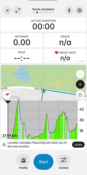

Various third party apps offer virtual running environments, and the Wahoo app offers route simulation. In these virtual environments/simulated courses, the app will control the grade of the KICKR RUN, automatically changing incline of the deck to correspond to the incline of the virtual/simulated running surface as you progress through the course, either running at a pace manually controlled with paddles or using RunFree mode. The app may offer visual media to match the terrain changes of the route.
Simulate a route on KICKR RUN in the Wahoo app
In the Wahoo app, with a Core or Pro Wahoo subscription, you can simulate a route you have imported as a file, or synced from a third party service or one of the routes Wahoo has curated.  The in-app will control the grade of the KICKR RUN's deck as you control belt speed manually using the paddles or RunFree mode and provide a real-time view of data, the topographic profile, or a simplified map view of the route.
For details, see KICKR RUN - Simulate a route indoors in the Wahoo app.
