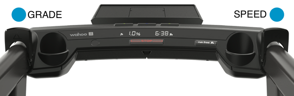

Multi-stage Speed and Grade paddles
The KICKR RUN's belt speed and deck grade can be manually controlled using the Speed (right) and Grade (left) paddles located at the front of the handrails just short of the console. The paddles are the primary controls for the treadmill. For more details, see Manual control mode [RUN].

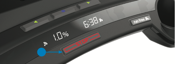

Stop button
The Stop button will bring the KICKR RUN's belt to a complete stop over several seconds.

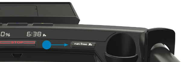

RunFree button
run-runfreebutton-600.png'
The RunFree button toggles RunFree mode on / off.

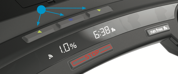

App interaction buttons
The app interaction buttons allow for various functionality, depending on features defined by the app to which you are connected.

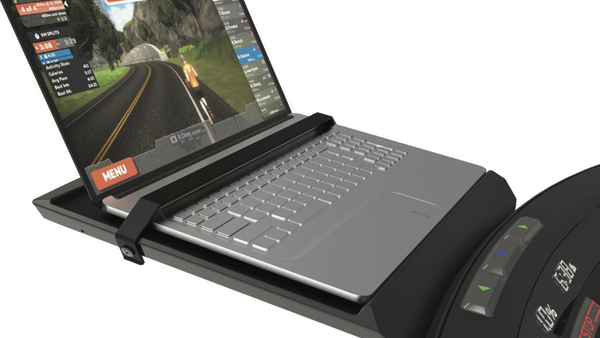

In the Wahoo app, the left and right buttons will move you back or forward, respectively, in the workout pages of an app.  The center button will create a lap.

Laptop / tablet shelf
The KICKR RUN is equipped with a shelf in front of the console that can hold up to a 17 inch laptop, with built in tablet / phone holder. It supports a maximum 15 lbs // 6.8 kg).

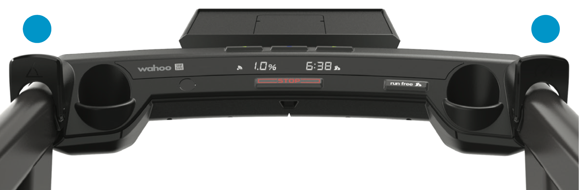

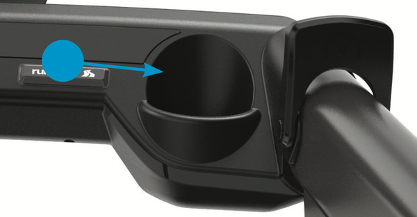

Water bottle holders
There are two standard water bottle holders, one on each side of the console.

Manual control mode is the default mode that allows you to manually control the belt speed and deck incline angle by manipulating the Speed (right) and Grade (left) paddles located at the front of the handrails just short of the console.
