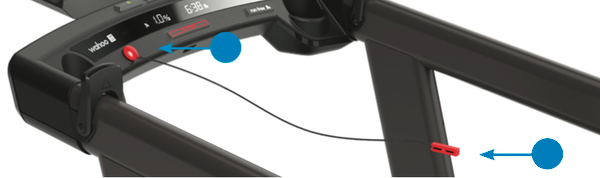

Install the safety key
KICKR RUN console with arrows to the safety key magnet panel and the tethered clip
The safety key consists of a clip tethered to a magnet.  Attach the clip to your shirt or waistband. Then attach the magnet to the coordinating panel on the console. If the magnet is disconnected from the panel, the KICKR RUN will bring the belt to a complete stop if in use, or disable the control and prevent the belt from moving.
The safety key should always be attached to the user's shirt or waist band before starting the treadmill.
The safety key should always be stored separately from the KICKR RUN and out of reach of children when not in use.

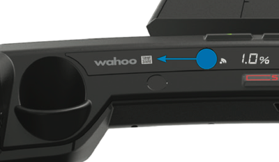

Scan the QR code
KICKR RUN console with an arrow pointing to the QR code on the left side
Use your phone's camera to scan the QR code on the left side of the console.
