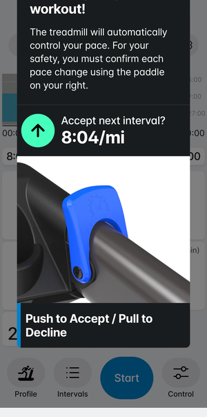

Run to match the pace of the belt, confirming any pace or pace/grade interval changes by pressing the Speed (right) paddle forward when prompted.  For safety, each pace and pace/grade interval change must be confirmed by pressing the paddle forward to confirm the next interval change.

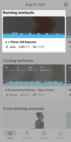

  2. Select your preferred structured running workout from the Wahoo app.
    • Home > Running Workouts
    • Select Start Now to open the workout in the Wahoo app.

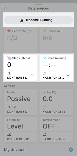

  3. Confirm the workout profile is set to Treadmill Running and the KICKR RUN appears as the data source for Speed, Cadence, and Controls.

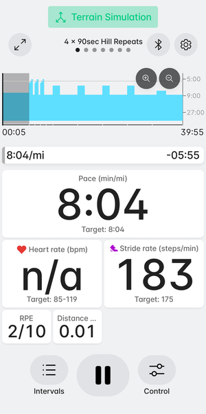

  5. Run to match the pace of the belt.
  6. Confirm any pace or pace/grade interval changes by pressing the Speed (right) paddle forward when prompted.  For safety, each pace and pace/grade interval change must be confirmed by pressing the paddle forward to confirm the next interval change.

  • The RUN defaults Pace and Grade control to 'On' for workout mode. Grade can be toggled off in the Control menu in the bottom right corner.

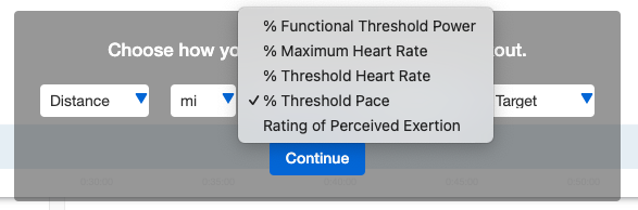

  • Only planned workouts with PACE target intervals (ex. in TrainingPeaks, intervals associated with '% threshold Pace') will control the speed of the treadmill belt.
  • The left and right app interaction buttons will move forward or backward in among the data pages in the Wahoo app.
  • The center app interaction button will start a new lap.
  • Grade control can be toggled off using the Control button in the bottom right corner.
  • You can also adjust overall workout intensity or toggle terrain simulation mode on or off.
