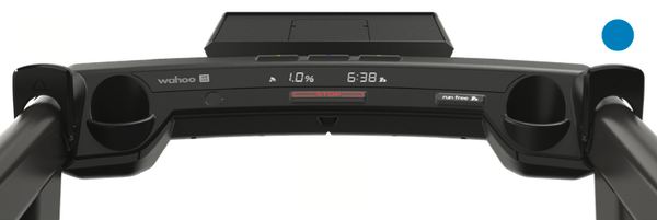

Safety Key
The safety key consists of a clip tethered to a magnet. The clip should be attached to the user's shirt or waistband. The magnet should then be attached to the coordinating panel on the console.  If the magnet is disconnected from the panel, the KICKR RUN will bring the belt to a complete stop if in use, or disable the control and prevent the belt from moving.
The safety key should always be attached to the user's shirt or waist band before starting the treadmill.
The safety key should always be stored separately from the KICKR RUN and out of reach of children when not in use.

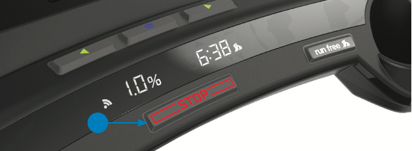

Stop Button
The STOP button will bring will bring the KICKR RUN to a complete stop over several seconds. It is the best way to stop the belt during regular use or for emergency stopping.

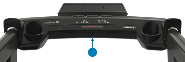

Time of Flight Sensor
The time of flight sensor, an advanced optical sensor located below the STOP button in the middle of the console, will detect the presence and location of the user on the treadmill. If the sensor no longer detects the presence of a user, it will bring the belt to complete stop. If the sensor is obscured (by a towel or other object placed over the sensor), it will bring the belt to a complete stop if in use, or disable the control and prevent the belt from moving.
