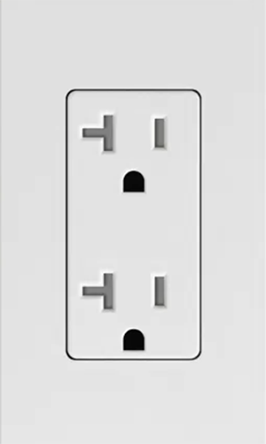

What is a 15 amp outlet? (US)
  • A standard 3 prong wall outlet (two vertical slits and the round ground pin.)
  • A 20 amp circuit and outlet are also acceptable. Note the horizontal extension from the longer slit.
