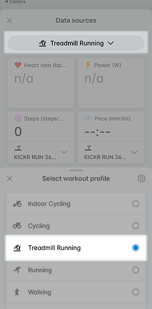

  1. Pair a KICKR RUN to the Wahoo app.
  2. Select the Record tab.
  3. Select the Treadmill Running workout profile at the top of the page just below Data Sources.

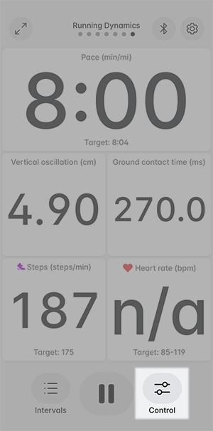

  4. Before, or after starting the activity recording, select the Control button at the bottom right.
  5. Select Lateral or Lateral and vertical.
  6. Exit the Control menu and continue or begin your run.
