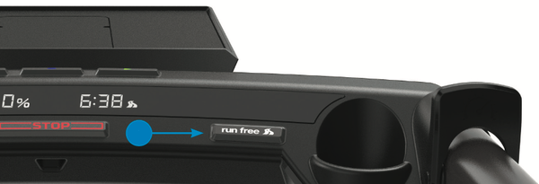

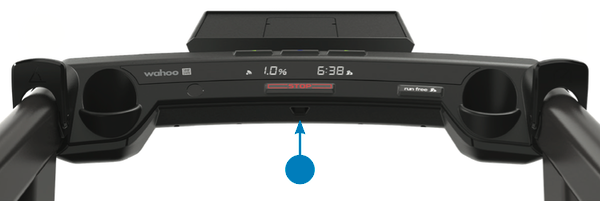

  2. Having reached a comfortable running pace, reach out your right arm, and ensure you are running at a distance on the treadmill deck that you can reach the STOP and RunFree buttons, but only with your arm close to fully extended.
    • When you press the RunFree button, the time of flight sensor will determine the distance between the part of your body that is at the height of the sensor and the sensor. If you move closer to the sensor, the KICKR RUN will increase the speed of the belt, and if you moves further away, it will slow the belt speed.
  3. Press the RunFree button.
