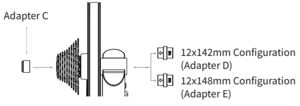

In the box
  • KICKR
  • AC power adapter
  • Quick release skewer (*pre-installed)
  • Disc Brake Caliper Spacer (install on break to prevent pads sticking)
  • 1.8mm axle spacer (for use with 10 speed cassettes)
  • Adapter A - Drive side adapter For 130mm and 135mm quick release (*pre-installed)
  • Adapter B - Reversible hub spacer for 130mm and 135mm quick release (*pre-installed)
  • Adapter C - Drive side adapter for 12x142mm and 12x148mm thru axle
  • Adapter D - Hub spacer for 12x142 thru axle
  • Adapter E - Hub spacer for 12x148mm thru axle
