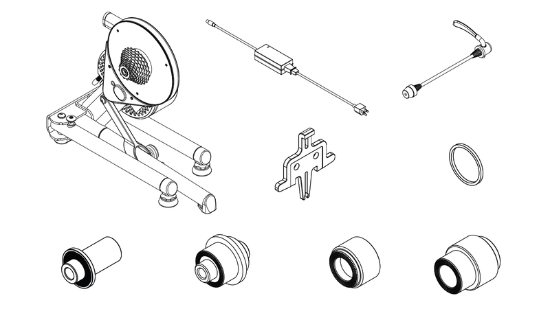

In the Box
  • KICKR v3 (2017) Smart Trainer
  • AC Power Adapter
  • Quick Release Skewer
  • RPM Cadence Sensor
  • Disc Brake Caliper Spacer
  • 1.8mm Cassette Spacer
  • Adapter A - Drive side adapter For 130mm and 135mm quick release
  • Adapter B - Reversible hub spacer for 130mm and 135mm quick release
  • Adapter C - Drive side adapter for 12x142mm and 12x148mm thru axle
  • Adapter D - Drive Side Adapter for 12x142 and 12x148 Thru Axle
  • Adapter E - Reversible hub spacer for Thru Axle
For in depth instructions, see the article on setting up your KICKR Smart Trainer.
