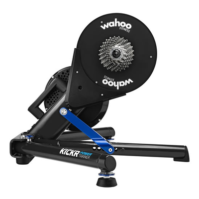

The Original Wahoo KICKR Power Trainer is the world’s most powerful indoor bike trainer! Take the back wheel off your bike and connect to the Wahoo KICKR for accurate power measurement, controlled resistance, open third-party software options, and the smoothest indoor riding on the market. Pain cave, meet your new best friend.

  • Part Number: WFBKTRNR
  • Box Dimensions: 26"L x 12"W x 22"H
  • Product Dimensions: 21" x 9" (54 cm x 23 cm) //  21" x 28" (54 cm x 71 cm) (legs open)
  • Weight: 47 lbs (21.3 kg) unboxed
  • Flywheel weight: 12.5 lbs lbs (6.6 kg)
  • Drivetrain:
    • Out of Box: 11 Speed Cassette
    • With Purchase and Installation of New Cassette: 8/9/10 Speed SRAM/Shimano
  • KICKR CLIMB Compatible: No
  • KICKR HEADWIND Compatible: No
  • Cadence: Requires cadence sensor
  • Front Wheel Block: Not needed
  • Accuracy: +/- 2%
  • Maximum Simulated Grade: 15%
  • Maximum Power Output: 1900 Watts
  • Connectivity: Bluetooth, ANT+
  • Wireless Software Updates: Yes (Wahoo App)
  • Max User Weight: 250lbs // 114 kg
  • 3rd Party Power Meter Support: Yes
  • Devices: iOS, Android, PC (Mac and Windows)
  • Power Requirements: 100-240V~1.5A 50-60 Hz
  • Noise Level: 70 dB
  • Dual Band Technology
    • Both ANT+ and Bluetooth Smart capabilities allow it to connect to both smartphones and GPS devices simultaneous or separately
  • Accurate Power with Built-In Power Meter
    • Wheel off design for direct, lab accurate power measurement at the hub that is consistent and calibrated throughout every grueling mile. Accurate to +/- 3%.
  • Controlled resistance
    • When connected to your device, it automatically sets your resistance via your favorite app or software
  • Realistic road feel
    • The KICKR flywheel is innovative and proven technology emulates the power and inertia experienced during outdoor riding. It provides the most realistic road feel especially when using virtual riding/training platforms like Wahoo SYSTM, Zwift, and Trainer Road.
  • Measures speed, distance, power, and cadence
    • Get all your vital cycling metrics on your indoor ride. Cadence only available when paired with a Wahoo RPM. 11 speed model includes an RPM and the 10 speed model does not.
  • Reduced Noise
    • Quiet as your favorite fluid trainer; no shouting required!
  • ANT+ FE-C Control
    • The KICKR now has ANT+ FE-C support, which allows the KICKR to be controlled from any FE-C enabled device or application, including products like Garmin bike computers.
  • Third Party App Compatibility
    • Works with popular training apps such as Kinomap, Virtual Training, and TrainerRoad
  • Third Party Power Meter Support
    • Compatible with a third party power meter.

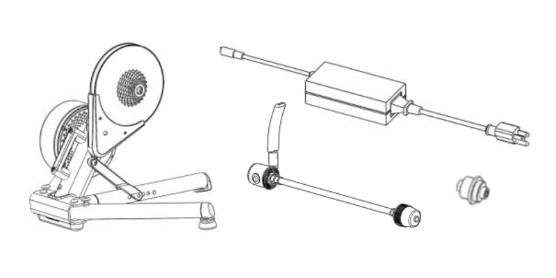

In the Box
  • KICKR v1 (2016) Smart Trainer
  • AC Power Adapter
  • Quick Release Skewer
  • RPM Cadence Sensor
  • Road/mountain bike adapter
  • Hydraulic Brake Pad Spacer
  • 1.8mm Cassette Spacer
For in depth instructions, see the article on setting up your KICKR Smart Trainer.
