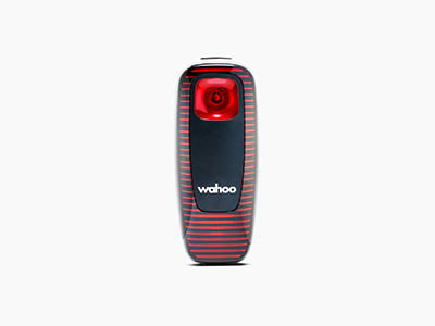

TRACKR RADAR Light modes
To toggle between light modes, tap the power button of the TRACKR RADAR.
| Model | Lumens | Battery life (Up to Hrs) |
| High Steady | 21 | 10 |
| Low Steady | 10 | 15 |
| High Flash | 53 | 15 |
| Low Flash | 18 | 20 |
Mode memory
The last-used light mode (the one currently in use when the radar is powered off) is saved. When powered on, the same mode is activated by default. This is a permanent feature and cannot be toggled on or off.

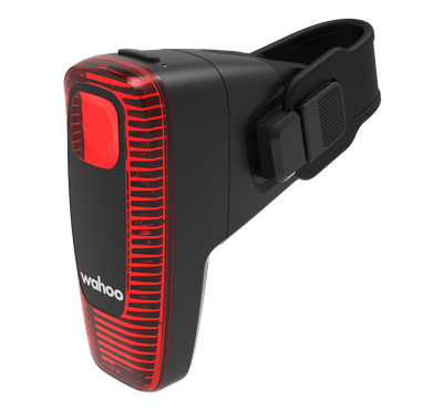

What is TRACKR RADAR?
TRACKR RADAR is Wahoo’s an all-in-one Cycling Radar & Tail Light that offers real-time vehicle detection, adaptive lighting, and seamless integration with ELEMNT GPS bike computers and other bike computers and watches compatible with the ANT+ Radar standard.

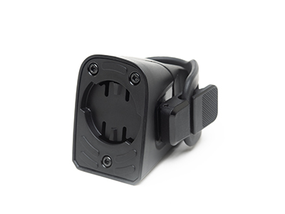

How do I mount the TRACKR RADAR?
The TRACKR RADAR includes a seatpost mount kit with 3 rubber inserts for use with round, aero or D-shaped seatposts. The mount kit also comes with a longer strap for larger diameter seatposts.
Spare mount kits are available for sale at wahoofitness.com and compatible alternative mounts can be purchased from KOM Cycling. Be sure to select the Wahoo TRACKR compatible version.
Please note the TRACKR RADAR uses the Wahoo computer quarter turn mounting standard, different from the pre-existing Garmin mounting standard.
