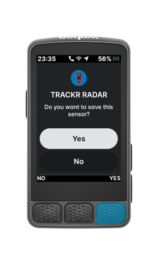

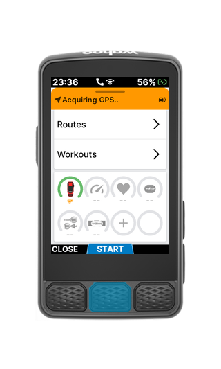

  1. Power on the TRACKR RADAR unit.

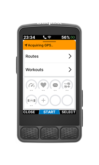

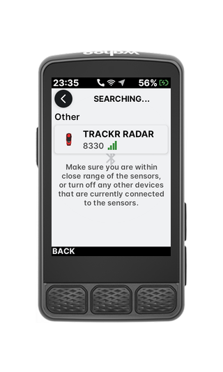

  2. Add a new sensor from the from the Ready to Ride dashboard or the Sensors page.
  3. If the ELEMNT does not prompt you to the TRACKR RADAR, scroll down in the available sensors list. If there are a large number of sensors available, the sensor list will be divided by sensor type.  Radar units will appear under Other at the bottom of the list.

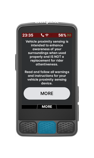

  4. Read and accept the safety warning statement.
  5. The TRACKR RADAR is paired.

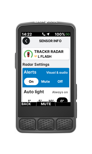

TRACKR RADAR Settings
Once your TRACKR RADAR is paired, additional settings (including mute) may be accessed by selecting the sensor from the Ready to Ride dashboard or the Sensors page.
On the computer

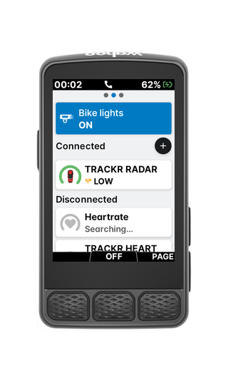

Connection / Battery status
The TRACKR RADAR will show as connected or not, and provide a battery level.
  • Good - battery > 20%
  • Low - battery < 20%

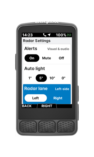

Alerts
Visual and audio alerts from the radar on the computer can be controlled independently
  • ON - The radar will produce visual and audio alerts on the computer.
  • MUTE - Visual alerts (radar lane and color changing status bar) are ON, but audio alerts are muted / OFF.
  • OFF - Visual alerts and audio alerts on the computer are OFF.

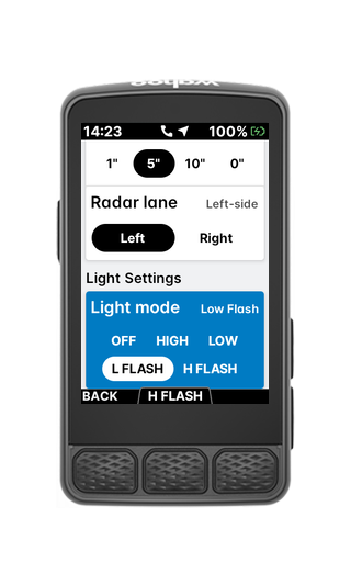

Radar Lane
The location of the radar lane can be moved from the left to the right side of the display.
  • LEFT - Radar lane / car track appears on the left side of display
  • RIGHT - Radar lane / car track appears on the right side of display

Light Mode
The four light modes can be manually selected and the light can be turned off completely independent of the radar.
  • Off
  • High steady
  • Low steady
  • Low Flash
  • High Flash

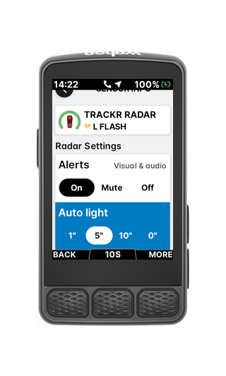

Auto light
If the auto light feature is enabled (1S, 5S, or 10S), and the radar has a tail light, the light will default to off.  When the radar senses a vehicle is approaching, the light will be turned on to the last light mode selected on the taillight or the computer* and remain illuminated for the period of time selected (1, 5, or 10 seconds) after the last vehicle in a sequence passes and then turn off.  If the auto light feature is disabled (set to OFF), the currently selected light mode will perform as defined by the light mode.
  • OFF - Light presents the last light mode selected on the light or computer,
  • 1S - Light is off and turned on to the last light mode selected as a vehicle is approaching + 1 second.
  • 5S - Light is off and turned on to the last light mode selected as a vehicle is approaching + 5 seconds
  • 10S - Light is off and turned on to the last light mode selected as a vehicle is approaching + 10 seconds
*If used with the Quick alert light mode enabled, the light will turn on to a high flash mode while the vehicle is approaching, and return to the last light mode selected for the remaining 1, 5, or 10 seconds before turning off.
Bike Lights
From the Sensors page, one step out from the TRACKR RADAR sensor page, (not accessible from the Ready to Ride dashboard), you can manually turn off all ANT+ smart lights connected to the computer.

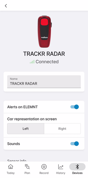

In the Wahoo app
In the Wahoo app > Devices tab > ComputerNameTRACKR RADAR sensor page, you can Mute or toggle off radar alerts on the computer entirely and select the side of the screen for the 'car representation' (radar lane). This duplicates the Alerts and Radar Lane settings on the computer described above.

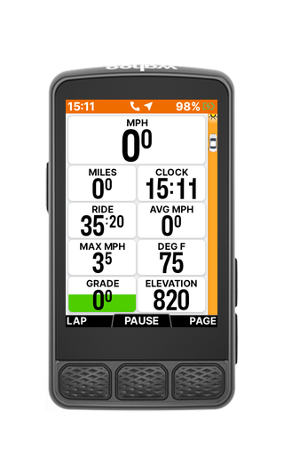

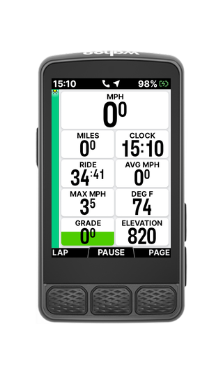

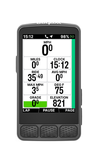

Radar experience
As discussed above, the radar lane can be placed on either side of the computer's display.  Vehicles will appear at the bottom of the screen as they are sensed and proceed upward toward the top of the display, indicating their approach to the rider.  As the vehicle appears on screen, the rider will be alerted by a change of radar lane color from green to orange or red, depending on the speed with which the vehicle is approaching.  Additionally, the status bar at the top of the computer will also flash the same color as the radar lane and the
If the taillight is on, a small yellow light icon will appear at the top of the radar lane. If it is off, the icon is absent.
r3-tr-radarleft-allclear-lighton-r320.png r3-tr-radarright-allclear-lightoff-r320.png r3-tr-radarright-alert-r320.png
