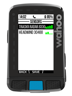

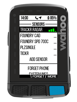

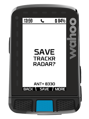

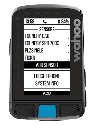

  1. Power on the TRACKR RADAR unit.
  2. Add a new sensor from the Settings/Sensors page.
  3. If the ELEMNT does not prompt you to pair the TRACKR RADAR, scroll down in the available sensors list. If there are a large number of sensors available, the sensor list will be divided by sensor type.  Radar units will appear under Other at the bottom of the list.

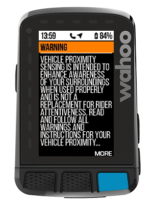

  4. Read and accept the safety warning statement.
  5. The TRACKR RADAR is paired.
  6. Select MORE to access TRACKR RADAR settings.

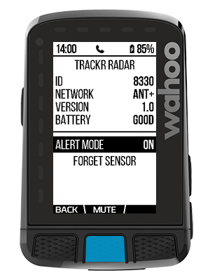

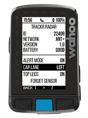

TRACKR RADAR Settings
Once your TRACKR RADAR is paired, additional settings (including mute) may be accessed by selecting the sensor from the Ready to Ride dashboard or the Settings page.
On the computer
Connection / Battery status
  • Good - battery > 20%
  • Low - batter < 20%

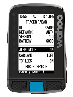

Alert mode
Visual and audio alerts from the radar on the computer can be controlled independently. Toggle them using the middle front button.
  • ON - Radar and visual and audio alerts are ON.
  • MUTE - Radar and visual alerts (radar lane) are ON, but audio alerts are muted / OFF.
  • OFF - Radar function is turned off, removing visual alerts (radar lane) and audio alerts OFF.

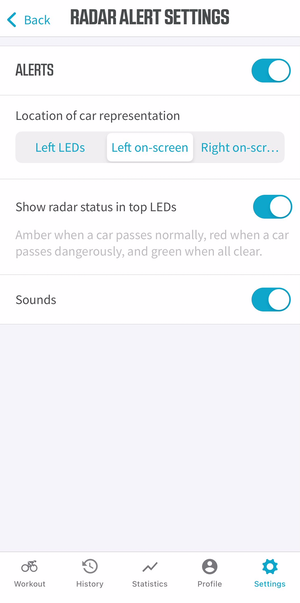

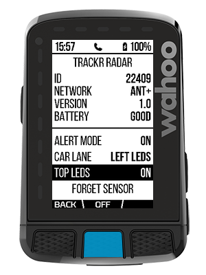

Car Lane
  • LEFT - Radar lane is on the left side of the screen
  • RIGHT - Radar lane is on the right side of the screen
  • LEFT LEDS - for devices with left side LEDs (ELEMNT, ROAM 1/2), car location and speed is represented by the left side LEDs
Top LEDs
  • ON - Top LEDs are used as a part of radar visual alerts.
  • OFF - Top LEDs are not used as a part of radar visual alerts.

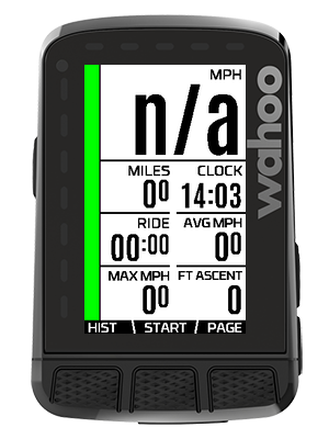

Radar experience
As discussed above, the radar lane can be placed on either side of the computer's display, or assigned to the left LEDs.  Vehicles (or lights) will appear at the bottom of the screen as they are sensed and proceed upward toward the top of the display, indicating their approach to the rider.  As the vehicle appears on screen, the rider will be alerted by a change of radar lane color from green to orange or red, depending on the speed with which the vehicle is approaching.
