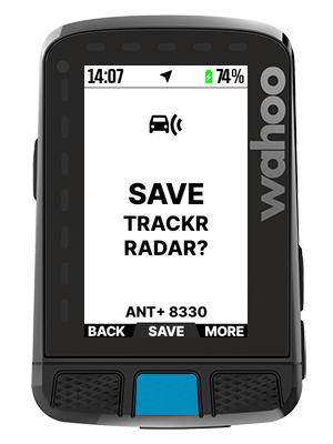

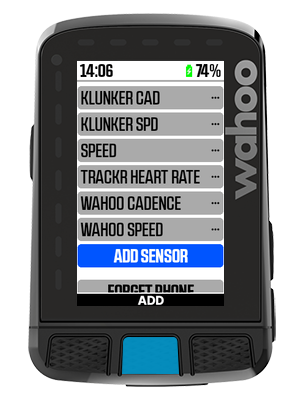

  1. Power on the TRACKR RADAR unit.
  2. Add a new sensor from the Ready to Ride screen or Settings/Sensors page.
  3. If the ELEMNT does not prompt you to pair the TRACKR RADAR, scroll down in the available sensors list. If there are a large number of sensors available, the sensor list will be divided by sensor type.  Radar units will appear under Other at the bottom of the list.
  4. Read and accept the safety warning statement.
  5. The TRACKR RADAR is paired.
  6. Select MORE to access TRACKR RADAR settings.

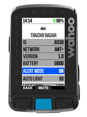

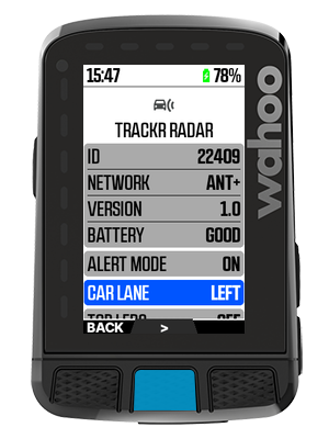

On the computer
Connection / Battery status
  • Good - battery > 20%
  • Low - batter < 20%

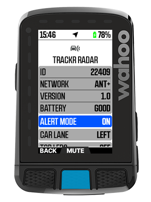

Alert mode
Visual and audio alerts from the radar on the computer can be controlled independently. Toggle them using the middle front button.
  • ON - Radar and visual and audio alerts are ON.
  • MUTE - Radar and visual alerts (radar lane) are ON, but audio alerts are muted / OFF.
  • OFF - Radar function is turned off, removing visual alerts (radar lane) and audio alerts OFF.

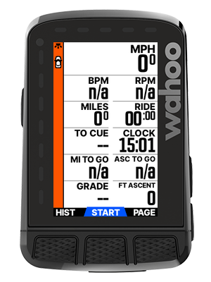

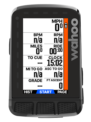

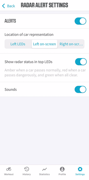

Car Lane
  • LEFT - Radar lane is on the left side of the screen
  • RIGHT - Radar lane is on the right side of the screen
  • LEFT LEDS - for devices with left side LEDs (ELEMNT, ROAM 1/2), car location and speed is represented by the left side LEDs

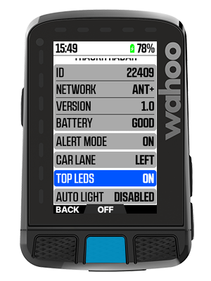

Top LEDs
  • ON - Top LEDs are used as a part of radar visual alerts.
  • OFF - Top LEDs are not used as a part of radar visual alerts.

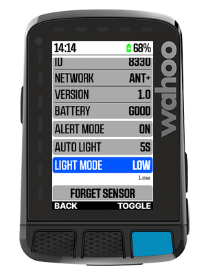

r2-tr-lightmode-r320.png r2-tr-autolight-r320.png r2-sensors-bikelightson-r320.png

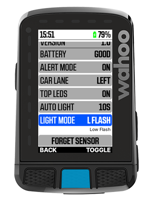

Light Mode
The four light modes can be manually selected and the light can be turned off completely, independent of the radar.
  • Off
  • High steady
  • Low steady
  • Low Flash
  • High Flash

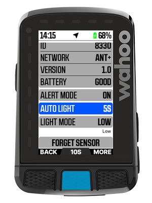

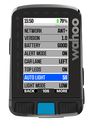

Auto light
If the auto light feature is enabled (1S, 5S, or 10S), and the radar has a tail light, the light will default to off.  When the radar senses a vehicle is approaching, the light will be turned on to the last light mode selected on the taillight or the computer* and remain illuminated for the period of time selected (1, 5, or 10 seconds) after the last vehicle in a sequence passes and then turn off.  If the auto light feature is disabled (set to OFF), the currently selected light mode will perform as defined by the light mode.
  • OFF - Light presents the last light mode selected on the light or computer,
  • 1S - Light is off and turned on to the last light mode selected as a vehicle is approaching + 1 second.
  • 5S - Light is off and turned on to the last light mode selected as a vehicle is approaching + 5 seconds
  • 10S - Light is off and turned on to the last light mode selected as a vehicle is approaching + 10 seconds
*If used with the Quick alert light mode enabled, the light will turn on to a high flash mode while the vehicle is approaching, and return to the last light mode selected for the remaining 1, 5, or 10 seconds before turning off.

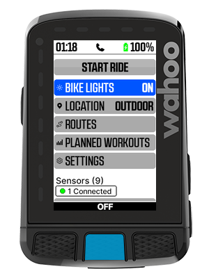

Bike Lights
From the Sensors page, one step out from the TRACKR RADAR sensor page, (not accessible from the Ready to Ride dashboard), you can manually turn off all ANT+ smart lights connected to the computer.

As discussed above, the radar lane can be placed on either side of the computer's display, or assigned to the left LEDs.  Vehicles (or lights) will appear at the bottom of the screen as they are sensed and proceed upward toward the top of the display, indicating their approach to the rider.  As the vehicle appears on screen, the rider will be alerted by a change of radar lane color from green to orange or red, depending on the speed with which the vehicle is approaching.  Additionally, the status bar at the top of the computer will also flash the same color as the radar lane.
If the taillight is on, a small yellow light icon will appear at the top of the radar lane. If it is off, the icon is absent.

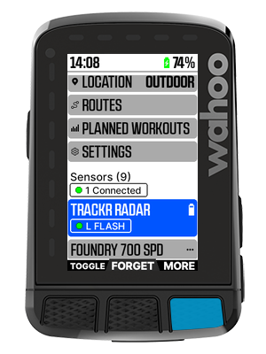

Remote manual light control
As described above, all lights connected to the computer can be turned on / off together from the Ready to Ride screen / Settings page.
Additionally, the TRACKR RADARs four light modes can be manually selected and the light can be turned off completely from the TRACKR RADAR's sensor page.
  • Off
  • High steady
  • Low steady
  • Low Flash
  • High Flash
