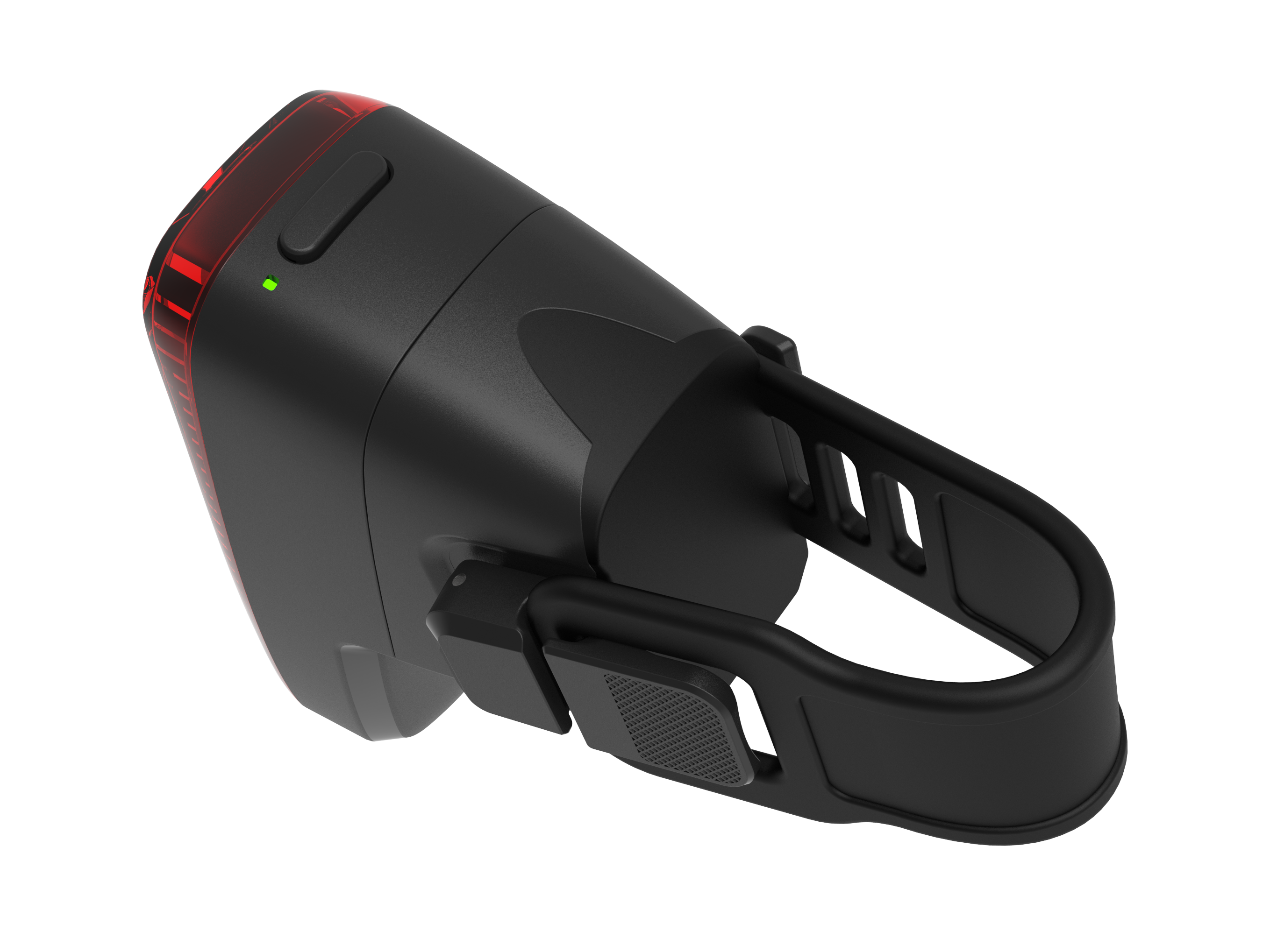

For round seatpost

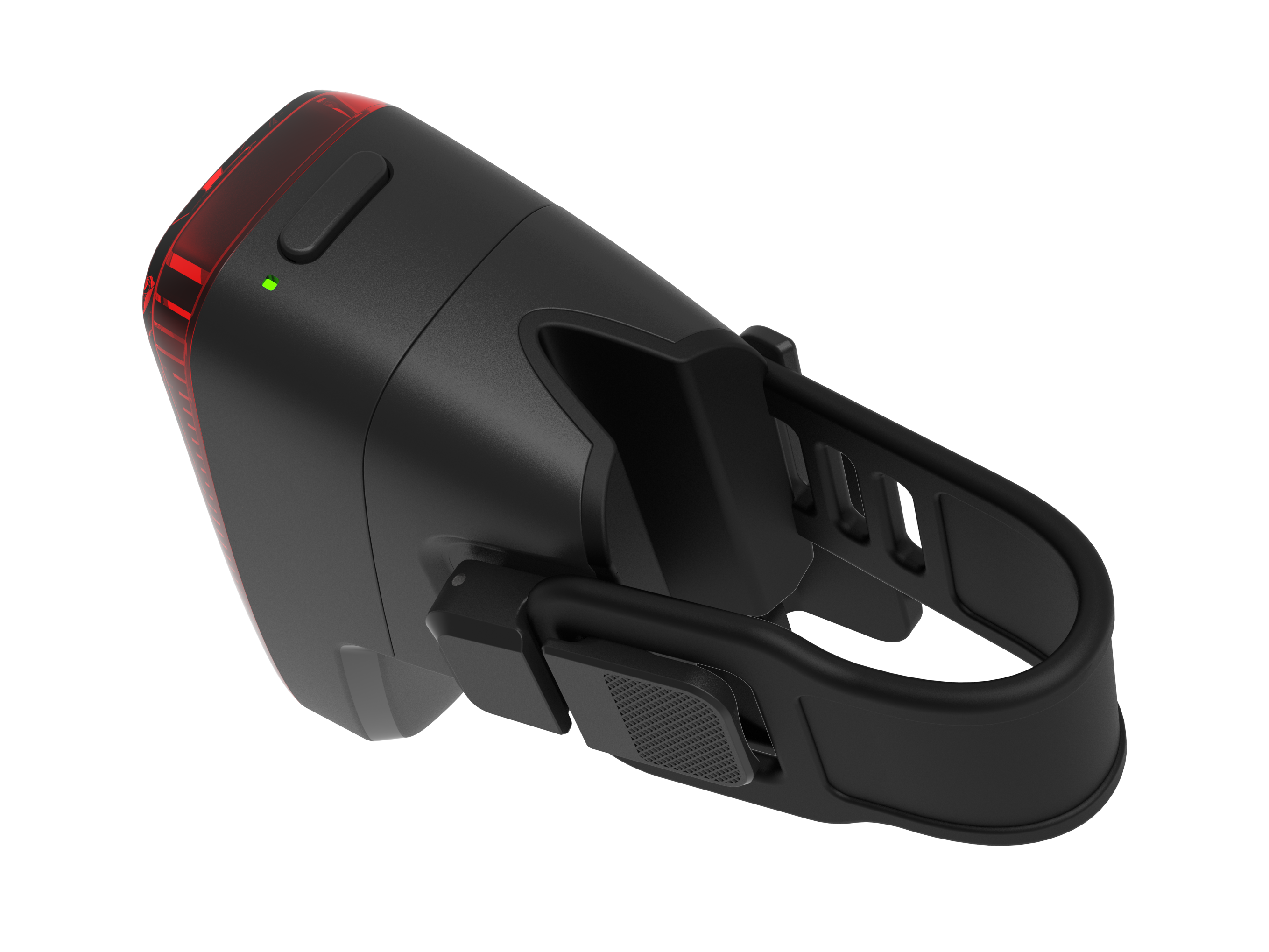

For an aero seatpost

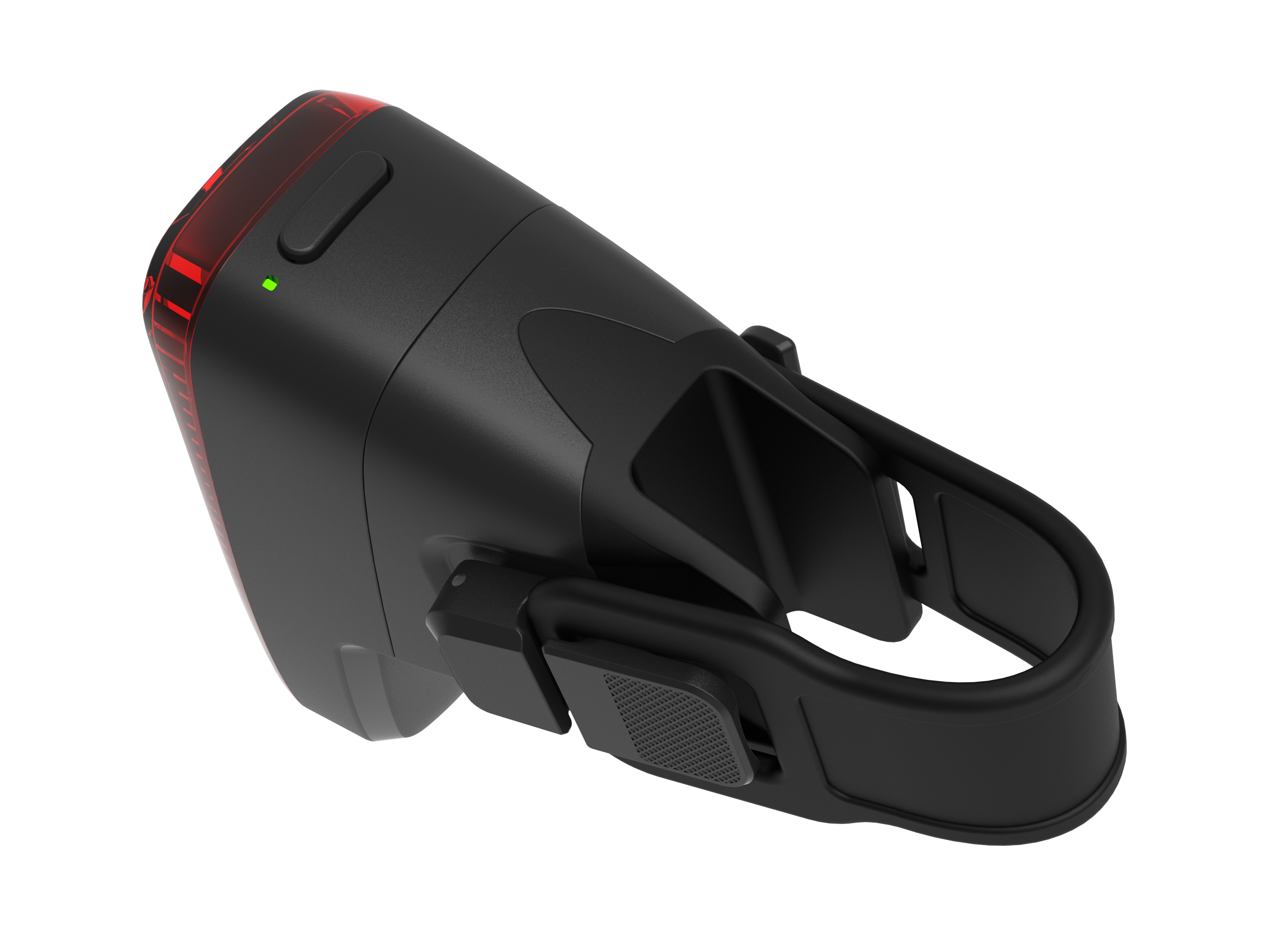

For a D-shape seatpost

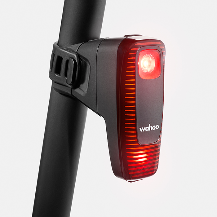

Mount the Radar
The TRACKR RADAR should be mounted securely with some combination of the provided mounting bracket, inserts, and straps or a third party mount with a Wahoo-compatible mounting interface.
The unit must be mounted so that there is nothing obstructing the rear face of the tail light, to allow for the radar to function properly.  Seat bags, racks, or, in the case of small frames, rear tires located between the tail light and approaching vehicles may result in false positive readings, or prevent the TRACKR RADAR from sensing approaching vehicles.  If you are receiving false positive readings or missing vehicles approaching, adjust the position of the mount, and remove any potential obstructions at the rear of your bicycle.
