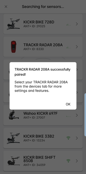

Pair TRACKR RADAR to the Wahoo app:

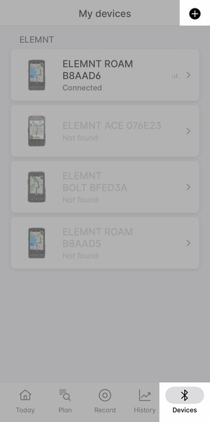

  1. Ensure the TRACKR RADAR is awake/on. Pressing the power button for 1+ second will ensure it is on.
  2. Open the Wahoo app and select the the Devices tab.

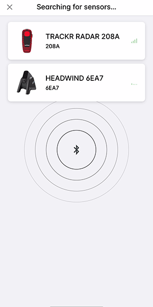

  3. Select the add (+) symbol, and then select Sensors.
  4. Wait for TRACKR RADAR XXXX* to appear in the list of available sensors.

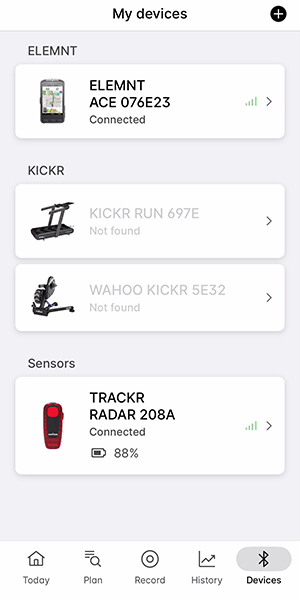

  5. Select the TRACKR RADAR from the available list.
  6. You will see the sensor has been paired. Select OK.
  7. The TRACKR RADAR is now paired and will show under My devices providing connection status and battery level when connected.
*XXXX (4x alphanumeric characters which are the hexadecimal value for the unit's ANT+ ID)
Wahoo app Devices tab, My devices list, with the + (add device) button highlighted Wahoo app Pair new menu with ELEMNT, KICKR and Sensors options, Sensors highlighted Wahoo app Searching for sensors... screen listing TRACKR RADAR 208A and a HEADWIND
Wahoo app pop-up "TRACKR RADAR 208A successfully paired!" with an OK button Wahoo app My devices list showing TRACKR RADAR 208A under Sensors as Connected with 88% battery

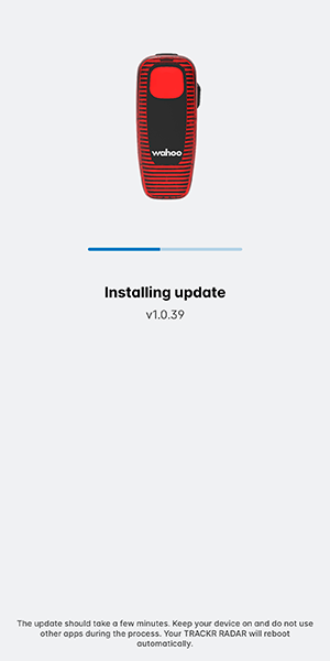

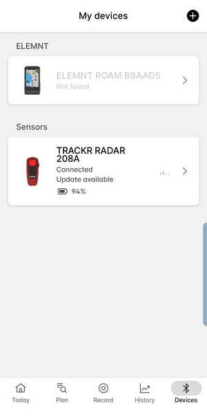

Update TRACKR RADAR firmware

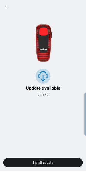

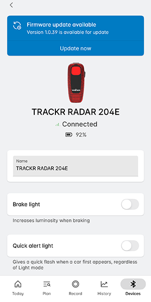

When the TRACKR RADAR is paired to the Wahoo app, the app will check the TRACKR RADAR's firmware against the firmware server for the current version. If its firmware is not current, Update available will appear under the sensor name in the Devices tab.
  1. Select the sensor and open the sensor details page.
  2. Update Firmware will appear under the sensor name.
  3. Select Update Firmware and follow directions to update the TRACKR RADAR's firmware.
Wahoo app My devices list with TRACKR RADAR 208A showing Connected and Update available Wahoo app TRACKR RADAR details page with a "Firmware update available" banner and Update now button Wahoo app Update available screen for TRACKR RADAR, version v1.0.39, with an Install update button

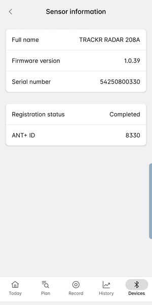

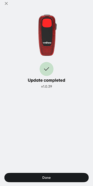

Wahoo app Installing update screen for TRACKR RADAR with a progress bar, v1.0.39 Wahoo app Update completed screen for TRACKR RADAR, v1.0.39, with a Done button Wahoo app Sensor information for TRACKR RADAR 208A showing firmware version 1.0.39, serial number and ANT+ ID
Because the firmware is updated via Bluetooth, which is a low-bandwidth protocol, please understand the update process will take several minutes.
You can always check the currently installed firmware version by navigating to the Sensor Information page (button located at the bottom of the TRACKR RADAR's sensor page.

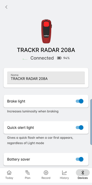

Enable TRACKR RADAR special feature modes
In addition to radar alerts and basic light modes (see TRACKR RADAR Features), the TRACKR RADAR offers several special feature modes which function with or without being connected to a GPS cycling computer or sport watch. These features are set to off by default and can only be enabled through the sensor menu when paired to the Wahoo app.
Brake light*
TRACKR RADAR uses an accelerometer to sense deceleration and function as a brake light, increasing luminosity when slowing down.**
Quick alert light*
When TRACK RADAR detects an approaching vehicle, it changes the flash pattern and increases luminosity of the light.
Battery saver mode*
TRACKR RADAR reduces the luminosity of the selected light mode to conserve battery whenever no vehicles are detected.**

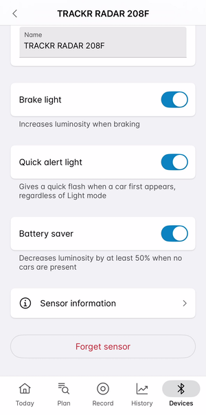

Enable the special feature modes
  2. From the Devices tab, select the TRACKR RADAR.
  3. Toggle the desired feature mode to on.
  4. Feature modes will remain set to the last selected setting unless factory reset.
Wahoo app My devices list showing TRACKR RADAR 208A under Sensors as Connected with 88% battery Wahoo app TRACKR RADAR 208A settings with Brake light, Quick alert light and Battery saver toggles on Wahoo app TRACKR RADAR settings scrolled down to Battery saver toggle, Sensor information and Forget sensor
