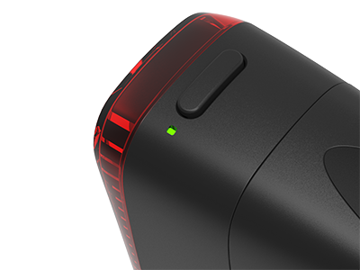

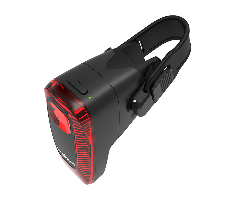

  • Blue LED slow flash: TRACKR RADAR is awake and active
  • Red LED quick flash: Powering off (hold down power button for +1 second to turn on/off)
Charging
TRACKR RADAR_LED CHANGES RED.png TRACKR RADAR_LED CHANGES ORANGE.png TRACKR RADAR_LED CHANGE GREEN copy.png
When connected to a power source, the LED flashes to indicate battery level while the TRACKR RADAR is charging.
Charging status can also be checked with the Wahoo app or on your ELEMNT device.
  • Red LED flash: 0-5%
  • Orange LED flash: 5-30%
  • Green LED flash: 30-100%
  • Green LED solid: Fully Charged
Low Battery Indicator
TRACKR RADAR_LED CHANGES ORANGE.png TRACKR RADAR_LED CHANGES RED.png blanktrans400x300.png
When not connected to a power source and the battery level is below 25%, the LED will flash to indicate a low battery state.
  • Orange LED flash 3x: 5-25%
  • Red LED flash for 2 seconds: 0-5%
Below 5%, the TRACKR RADAR will shut down. If powered on below 5%, the LED will flash red for 2 seconds, then shut down again.
