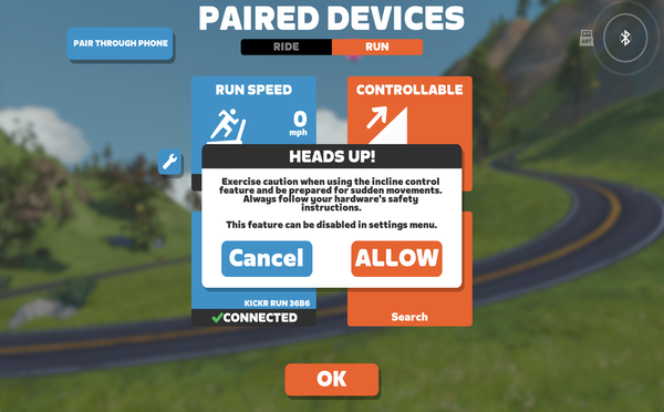

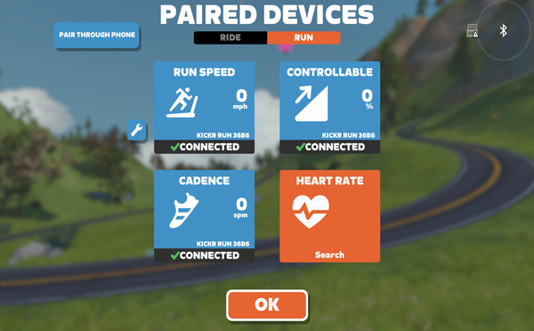

In the Paired Devices screen,
  1. Select RUN (as opposed to RIDE).
  2. Select Run Speed, Cadence, and Controllable.
  3. Select KICKR RUN for each connection type.
  4. Read and confirm the safety announcement.
  5. Confirm that the KICKR RUN is paired for Run Speed, Cadence, and Controllable.
  6. Select OK.

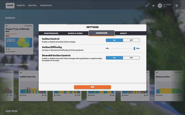

Enable grade / Incline control in Zwift hardware settings
From the Home screen,
  1. Select your Profile icon in the right section of the header.
  3. In the Settings menu pop-up, select Hardware.
  4. To enable grade control, toggle Incline Control On.
    • This will enable positive (0 to +15%) grade control by Zwift courses.
  5. To enable downhill grade control (0 to -3%), also toggle Downhill Incline Control On. run-zwift-settingshardware-600.png
  6. Select OK.
Zwift disables grade control in structured workouts. Grade control exists in free run (Just Run) mode only.

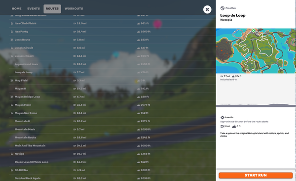

Test Zwift grade control in free run mode
To quickly test Zwift's control of grade in free run mode, we suggest running a short dynamic Route in Zwift like Loop de Loop.
  1. Select Routes.
  2. Scroll down to select Loop de Loop
  3. Select Start Run.
