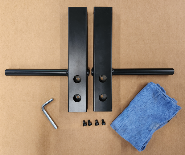

  • 2x rear carry handles (that were removed and left with you at installation*).
  • 4x 6mm hex bolts (that were removed and left with you at installation*).
  • A 6mm hex key.
  • If the treadmill is placed directly on a delicate floor, a pair of rags, pieces of cardboard, or some other material to place between the carry handle frame and the floor when bolting them in place.

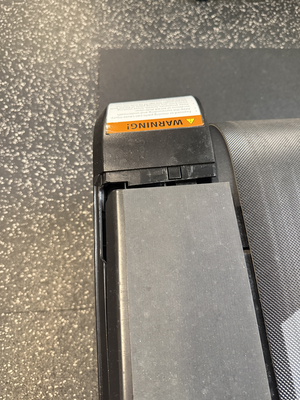

  3. Remove both rear plastic side covers by pressing gently on the side of the cover and sliding it backward. Note the location and angle at which they are removed.  There will be some resistance as they are clipped in place. Set the covers aside.

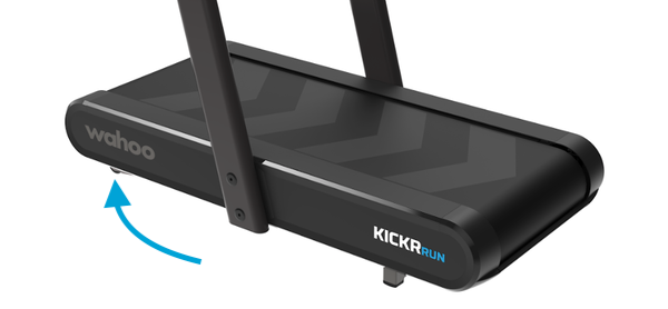

  4. From the back of the treadmill, pull up on the deck. You should feel the gas struts attached to the rear feet extend, raising the deck slightly.  They will naturally compress down again slowly.

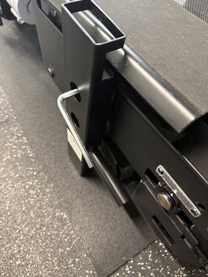

  5. Install the rear carry handles, with each handle facing toward the rear of the treadmill, using 2x 6mm hex bolts and the 6mm hex key. You may need to pull up on the deck again, or have someone hold it fully extended while bolting on the first carry handle.

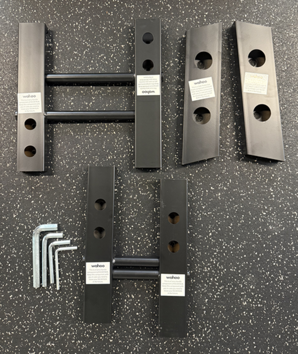

To disassemble and attach the shipping handles for moving a KICKR RUN, you will need:
  • At least four people, prepared to safely lift the 429 lb treadmill
  • 8x 6mm hex bolts (that were removed and left with you at installation*)
  • 4x 14mm hex bolts (that were removed and left with you at installation*)
  • A 6mm, 8mm, 10mm, and 14mm hex key
  • If the treadmill is placed directly on a delicate floor, rags, pieces of cardboard, or some other material to place between the carry handle frame and the floor, when bolting them in place.
*If the two rear carrying handles were not left with you, or you have misplaced or discarded them, please contact our support team to acquire replacements.

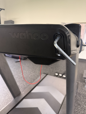

  4. Slightly loosen the stanchion arm bolts.
  5. Remove the 4 console bolts.

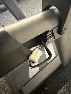

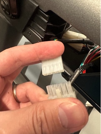

  1. Slowly pull the console out, revealing the internal paddle wiring. Gently unplug the wiring harnesses. Do this by gently lifting up the small plastic clip fastening the two ends together and sliding them apart (as seen in the first two images below)
  2. Continue to slide the console back to remove it.

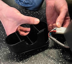

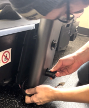

  3. Remove the bottom cap to the right side stanchion. This is inserted into the bottom of the stanchion arm (as seen in the 3rd image below), and you simply need to pull down on this, then slide it out. It may take two hands, as they can be slightly stiff.

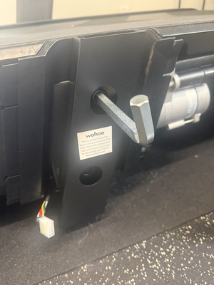

  4. Gently unplug the wiring harness located at the base of the stanchion arm. Do this by gently lifting up the small plastic clip fastening the two ends together and sliding them apart

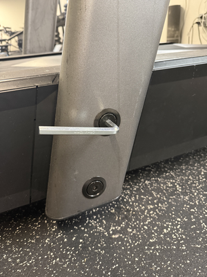

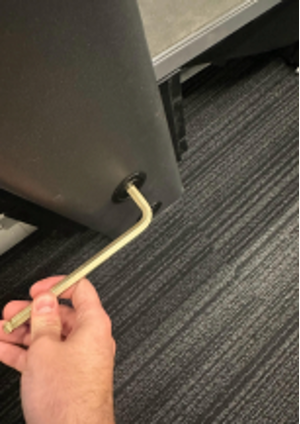

  1. Remove the side stanchion bolts (10mm hex key) and side stanchion arms (note: the stanchion arms are quite heavy).
  2. Install the middle shipping handle (14mm hex key).

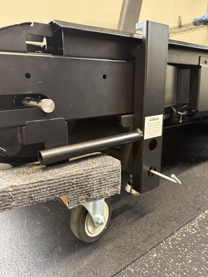

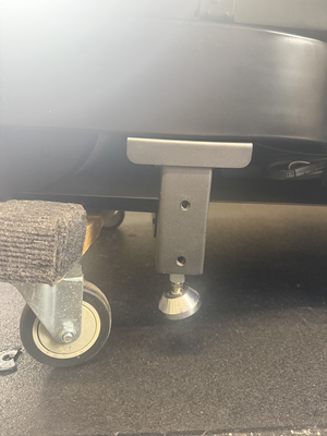

  1. Team lift the end of the KICKR RUN and use a furniture dolly to keep the RUN lifted.
  2. Install the rear end shipping handles on both sides of the treadmill (long handle - 8mm hex key).
  3. Install the front end shipping handles on both sides of the treadmill (short handle - 8mm hex key).
