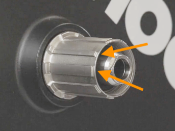

  3. Examine the freehub body and note the location of the one spline that is narrower than the others. This keyed pattern exists on the inside edge of the cassette cogs and ensures that the cassette can only be installed one way. Rotate the narrow spline to the top and then install cogs and spacers as a group or one by one, ensuring that the cogs are installed large to small.
