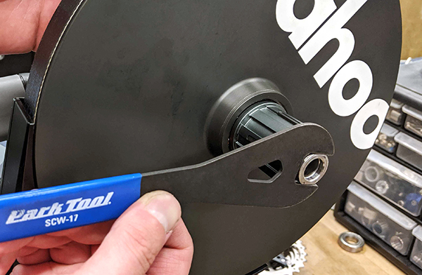

  2. Use the 17mm cone wrench** to remove the existing original lock nut and freehub body. Hold the pulley with your free hand for stability.
    **KICKR v6 and updated replacement adapter kits come with lock nuts with 14mm wrench flats, rather than 17mm.
    Park Tool SCW-17 cone wrench on the freehub lock nut while one hand steadies the KICKR pulley
    Original freehub body on the KICKR axle with the lock nut being removed by hand

  6. Screw on the original lock nut and tighten with the 17mm cone wrench**, again holding the pulley with your other hand for stability. Tighten until snug, being sure to avoid applying excessive force.
    *KICKR v6 and updated thru axle adapter kits come with lock nuts with 14mm wrench flats, rather than 17mm.
  7. Park Tool SCW-17 cone wrench tightening the lock nut on the installed Campagnolo freehub
    Campagnolo freehub installed on the KICKR with the lock nut seated at its end
