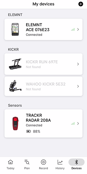

  1. Ensure the TRACKR RADAR is awake/on. Pressing the power button for 1+ second will ensure it is on.
  2. From the Devices tab, select the TRACKR RADAR.

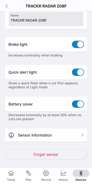

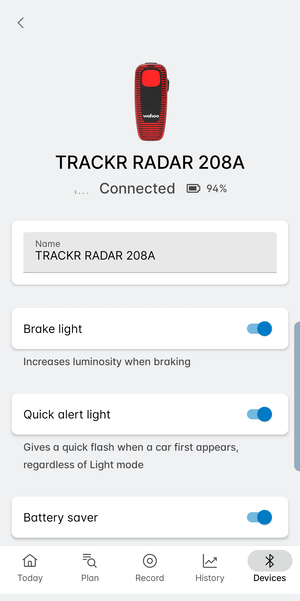

  3. Toggle the desired feature mode to on.
  4. Feature modes will remain set to the last selected setting unless factory reset.
