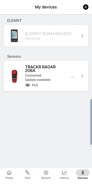

When the TRACKR RADAR is paired to the Wahoo app, the app will check the TRACKR RADAR's firmware against the firmware server for the current version. If its firmware is not current, Update available will appear under the sensor name in the Devices tab.

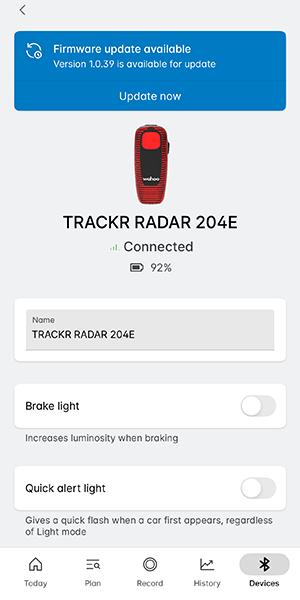

  1. Select the sensor and open the sensor details page.
  2. Update Firmware will appear under the sensor name.

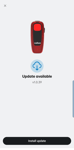

  3. Select Update Firmware and follow directions to update the TRACKR RADAR's firmware.

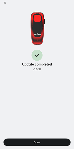

Wahoo app My devices list with TRACKR RADAR 208A showing Connected and Update available Wahoo app TRACKR RADAR details page with a "Firmware update available" banner and Update now button Wahoo app Update available screen for TRACKR RADAR, version v1.0.39, with an Install update button

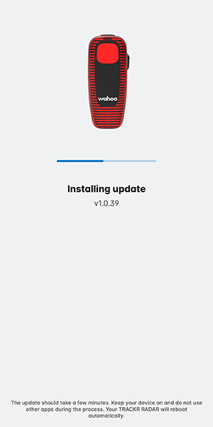

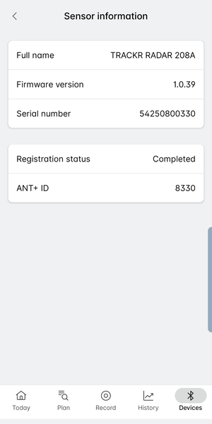

Wahoo app Installing update screen for TRACKR RADAR with a progress bar, v1.0.39 Wahoo app Update completed screen for TRACKR RADAR, v1.0.39, with a Done button Wahoo app Sensor information for TRACKR RADAR 208A showing firmware version 1.0.39, serial number and ANT+ ID
Because the firmware is updated via Bluetooth, which is a low-bandwidth protocol, please understand the update process will take several minutes.
You can always check the currently installed firmware version by navigating to the Sensor Information page (button located at the bottom of the TRACKR RADAR's sensor page.
