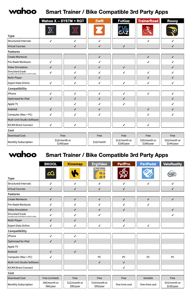

KICKR App Compatibility
Download the KICKR 3rd Party App Comparison Table in PDF format
