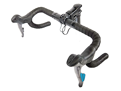

Two shifter buttons on the outside of each brake lever
Used for Shimano and SRAM shifting configurations.

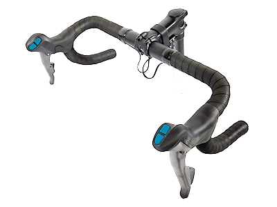

2 multi-use buttons on top of each shifter body
Manually tilting the KICKR BIKE
BIKE V2
Left and Right top shifter buttons simultaneously (top shifter buttons denoted in the image above)
  • Both front buttons (the buttons furthest from the rider)- Tilt down
  • Both rear buttons (the buttons closest to the rider)- Tilt up
Left side - app contextual
  • in Zwift
    • Front: Ride On!
    • Rear: U-Turn
Right side - app contextual
  • in Zwift
    • Front: Power Up
    • Rear: U-Turn

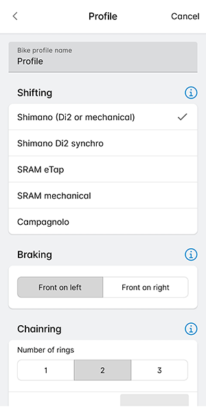

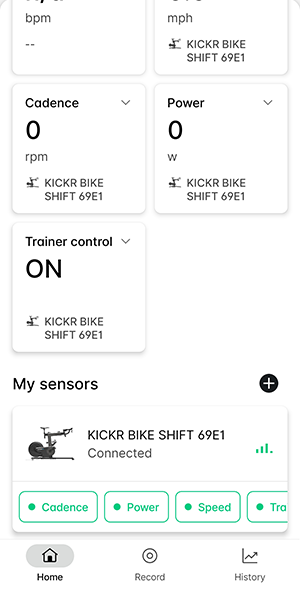

Create a shifter profile
1.  Ensure the device running the Wahoo app has an active data connection.
2. Pair your BIKE to the Wahoo app.
3. Once paired, navigate to Home > My sensors > BIKE
4. Scroll down to the Bike profiles section and select Create bike profile.

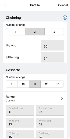

5. Select your preferred Shifting and Braking configuration.

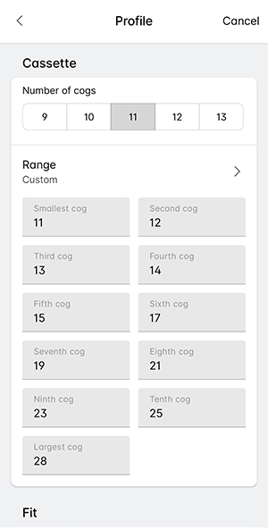

6. Select your preferred number of chainrings and chainring tooth count.
7. Select your preferred number of cassette cogs.
shifter-shiftingbraking-300.png shifter-chainring-300.png shifter-cassettecogs-300.png

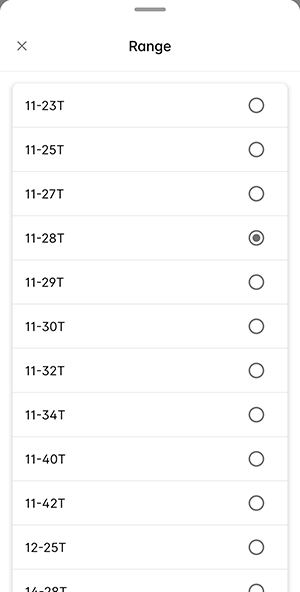

8. Select Range and select your preferred preset cog range or Custom to select the tooth counts of your preferred custom cog set.
9. Select the back button in the upper left hand corner. The selected settings are automatically saved.
shifter-cassetterange-300.png shifter-cassettecustom-300.png shifter-cassettecogs-300.png

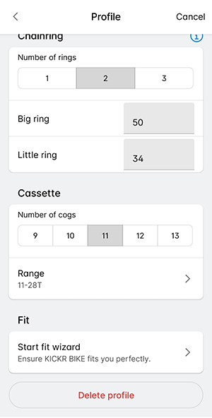

Edit a shifter profile
1. Open Home > My sensors > BIKE.
2. Scroll down to Bike profiles and select the profile you wish to edit.
shifter-editbikeprofiles-300.png blanktrans300x600.png blanktrans300x600.png
3. Select your preferred Shifting and Braking configuration.
4. Select your preferred number of chainrings and chainring tooth count.
5. Select your preferred number of cassette cogs.
6. Select Range and select your preferred preset cog range or Custom to select the tooth counts of your preferred custom cog set.
7. Select the back button in the upper left hand corner. The selected settings are automatically saved.
Delete a shifter profile
2. Scroll down to Bike profiles and select the profile you wish to delete.
3. Scroll down to the bottom of the profile and select Delete profile.
shifter-editbikeprofiles-300.png shifter-cassettecogs-300.png blanktrans300x600.png
