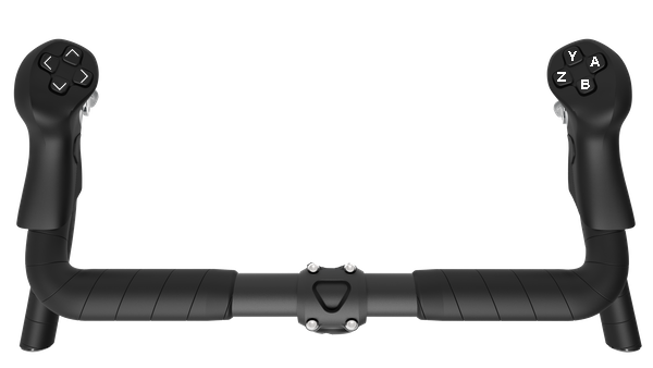

For Zwift...
Left hood
  • left-button-zwift.png LEFT
    • Navigate left (menu/action bar) or
    • Cycle the mini map (in ride)or
    • Go left at an intersection (in ride)
  • up-button-zwift.png UP
    • Navigate up (menu/action bar) or
    • Display or hide the action bar or
    • Go straight at an intersection (in ride)
  • right-button-zwift.png RIGHT
    • Navigate right (menu/action bar) or
    • Go right at an intersection (in ride)
  • down-button-zwift.png DOWN
    • Navigate down (menu/action bar) or
    • Display the look-back camera (in a Zwift Event)
Right hood
  •   A   - Select
  •   B   - Back or Display Menu when in a ride or workout
  •   Y   - Use a power up (in ride) or Skip an interval (in a workout)
  •   Z   - Return a Ride On (in ride) or hold to give a Ride On to 5 riders in your vicinity

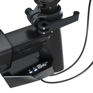

HCU button
BIKE v1 and v2 also have a single button on the head control unit on the drive (right) side of the bike.
  • Tap to lock (secure manual only) or unlock (provide app control of) tilt functionality.
  • Double tap to level the BIKE to neutral tilt position.

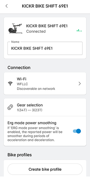

1.  Ensure the device running the Wahoo app has an active data connection.

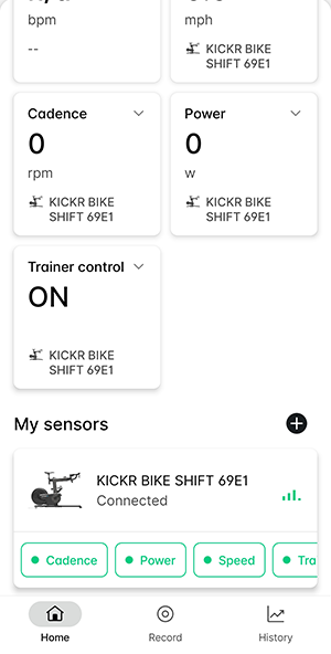

2. Pair your BIKE to the Wahoo app.
3. Once paired, navigate to Home > My sensors > BIKE

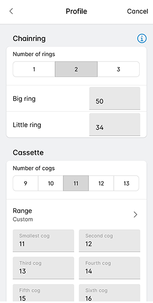

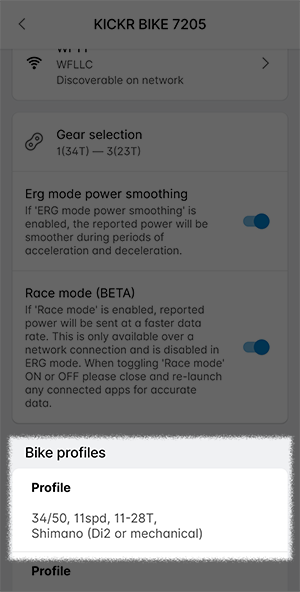

4. Scroll down to the Bike profiles section and select Create bike profile.

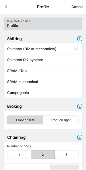

5. Select your preferred Shifting and Braking configuration.
6. Select your preferred number of chainrings and chainring tooth count.
7. Select your preferred number of cassette cogs.
shifter-shiftingbraking-300.png shifter-chainring-300.png shifter-cassettecogs-300.png

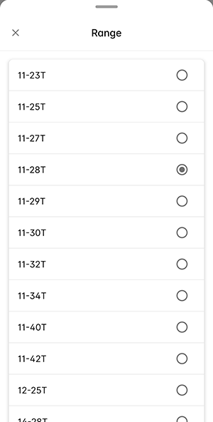

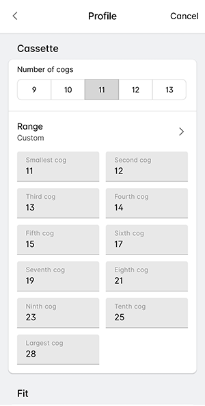

8. Select Range and select your preferred preset cog range or Custom to select the tooth counts of your preferred custom cog set.
9. Select the back button in the upper left hand corner. The selected settings are automatically saved.

Edit a shifter profile
1. Open Home > My sensors > BIKE.
2. Scroll down to Bike profiles and select the profile you wish to edit.

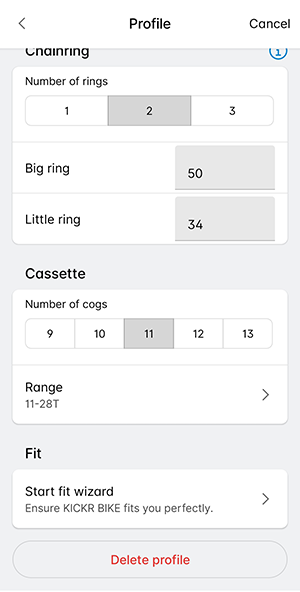

Delete a shifter profile
2. Scroll down to Bike profiles and select the profile you wish to delete.
3. Scroll down to the bottom of the profile and select Delete profile.
