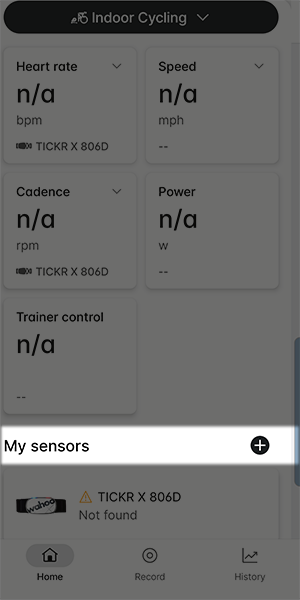

  1. With your KICKR CLIMB paired to your Wahoo smart trainer (instructions here), open the Wahoo app and select Home > My Sensors

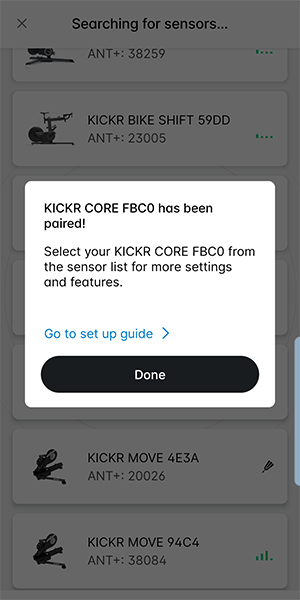

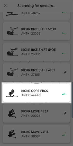

  2. Select your smart trainer from the list of saved sensors. If its not saved, select (+) or Pair Sensor and select it from the list of sensors that appears.

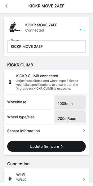

  3. On the smart trainer sensor details page, wait until the trainer is fully connected (up to 90 seconds), then ensure KICKR CLIMB Connected is displayed as below.
    Note: If the CLIMB does not show as connected, power off the KICKR, then unpair the CLIMB while the KICKR remains off. Next, power on the KICKR and re-select it on the Add New Sensor page. Once connected, pair the CLIMB once more to see it appear.

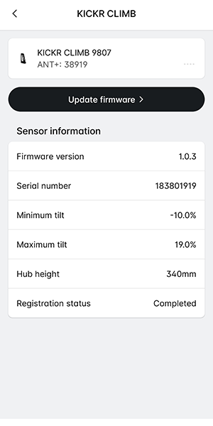

  4. Modify the Wheelbase and Wheel type/size values on the sensor page to customize them to your bike. These values will inform the maximum and minimum possible tilt values.
