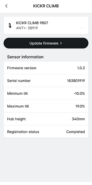

  4. Once paired, be sure to update your KICKR CLIMB firmware before riding.

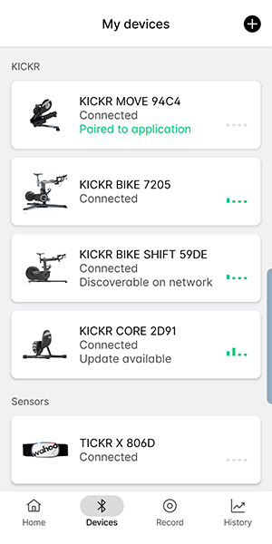

Set wheelbase and wheel type in the Wahoo app
Once the CLIMB is paired to the trainer, the CLIMB sensor details, bike wheelbase and tire circumference settings, tilt, and hub height status, and firmware update process are accessed from the trainer's sensor details page in the Devices list.
