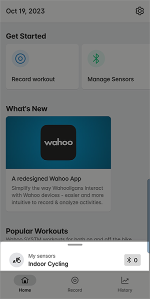

  3. Open the My Sensors drawer at the bottom of the Home tab.

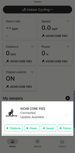

    Upon establishing a connection with your trainer, the Wahoo app will determine if your trainer or CLIMB's firmware is out of date. If an update is available, the app will display a notice - Update Available.

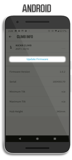

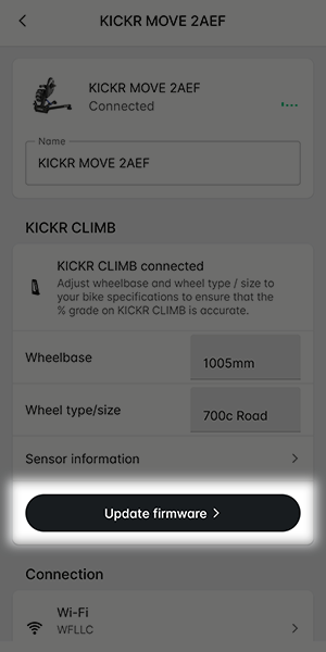

  5. Select Update firmware under the KICKR CLIMB section of your trainer's (KICKR, MOVE, CORE, or SNAP) sensor details page. If there is an Update firmware button above this section, immediately below your trainer model name, this means there is also a firmware update available for your trainer.

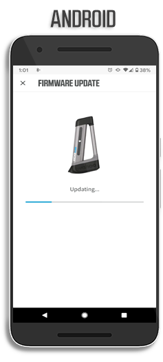

  6. The app will list the firmware version update available. Select Install update and leave your device near the trainer/CLIMB until the update is complete.
  7. Once the update is finished, you're prompted to toggle Bluetooth® off and back on in the iOS/Android Settings app to refresh the connection. We also recommend you restart your trainer and CLIMB by unplugging them for 30 seconds after an update.
