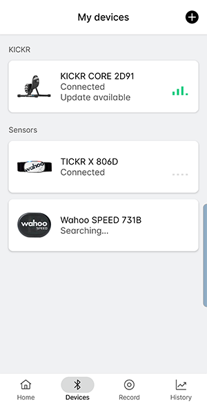

When a sensor is paired, the app will check the sensor's firmware against the firmware server for the current version. If the sensor's firmware is not current, Update available will appear under the sensor name in the Devices tab.
  1. Navigate to the Devices tab.

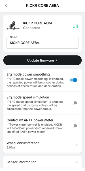

  2. Select the sensor and open the sensor details page.
  3. Update Firmware will appear under the sensor name.
  4. Ensure that the sensor is only connected to the Wahoo app on your phone or tablet (and not also to Zwift, TrainerRoad, or another app on another device) and that your phone is not paired to any other Bluetooth® devices (including headphones or smartwatches) and then
  5. Select Update Firmware and follow directions to update the sensor firmware.

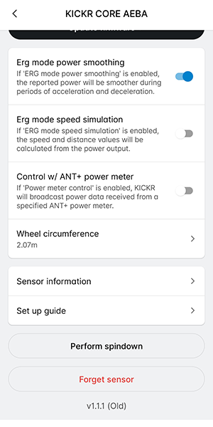

You can always check the currently installed firmware version by scrolling to the bottom of the sensor details page where the version number and its status -- (Old or Latest) will be listed.
