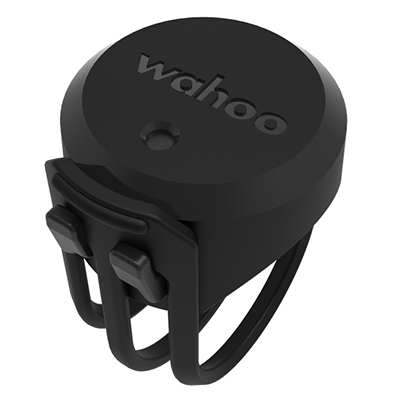

TRACKR SPEED sensor, a round black Wahoo-branded pod with an LED window and rubber hub mounting strap

  • Weight: .46 oz (13 g) with strap
  • Battery: CR2032 Coin Cell
  • Battery Life: Over 200 Active Hours
  • Water Rating: IPX7 (up to 1 meter for 30 minutes)
  • Maximum Hub diameter: Fits up to 40mm (1.57") diameter hubs
    • TRACKR SPEED is recommended for road, gravel, and XC MTB hubs. Fitment to oversized Enduro hubs may be limited.
  • Connectivity: ANT+ and and a single Bluetooth connection
  • Supported Devices: Cycling computers, fitness watches, and iOS, Android, MacOS, and Windows-based apps,

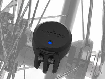

How to mount TRACKR SPEED
TRACKR SPEED mounted on a bike wheel hub among the spokes, blue LED lit
The TRACKR SPEED ships fully assembled and ready to mount on the hub of your front or rear wheel, depending on your preference.
While holding the sensor pod in place on your selected hub, gently stretch the the rubber strap around the hub to secure it around bottom two hooks on the the opposite side of the pod.
