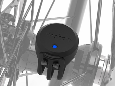

If the sensor is unresponsive (no LEDs)...
Before first use --
To wake the sensor for first use, spinning the wheel of the bicycle will activate the accelerometer of the TRACKR SPEED. Once the sensor is awake, the blue LED will blink slowly and will flash quickly before going solid once the sensor is successfully paired to an app or device.
Any other time --
  1. Confirm unit is awake and responsive by spinning the wheel of the bicycle to activate the accelerometer of the TRACKR SPEED, once awake the blue LED will blink slowly and will flash quickly before going solid once the sensor successfully pairs to an app or device.
  2. Check the battery connection. While the battery is removed, flex the metal prongs that connect to the battery by pressing them towards the middle of the sensor pod. If the prongs are pushed down too far, this can prevent a strong connection with the battery.
  3. If unresolved, please try replacing the battery - data can fail to transmit properly on a low battery. Please note that Wahoo does not recommend the use of any battery with a "bitter/child deterrent" coating (specifically, but not limited to those made by Duracell). These batteries are not approved for use Wahoo devices and may only be used at your own risk should you choose to use them. This coating has the potential to reduce battery performance and may degrade sensor functionality. Wahoo recommends using Panasonic coin-cell batteries or another name brand for optimal performance and tracking.
