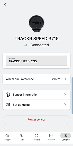

  1. With your sensor paired and actively connected to the app, navigate to the paired TRACKR SPEED sensor page:
    • In the Wahoo App -- Home > Devices > TRACKR SPEED XXXX or
    • In the ELEMNT app -- Settings > Sensors > TRACKR SPEED XXXX]

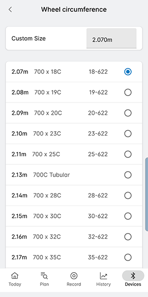

  2. Select Wheel Circumference.
  3. Enter your bike's wheel circumference under Custom Size or select a from the list. You can explore more tire sizes in our Tire Size Chart.
  4. The wheel circumference will be set for all Workout Profiles associated with the sensor.
