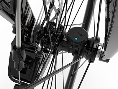

The TRACKR SPEED ships fully assembled and ready to mount on the hub of your front or rear wheel, depending on your preference.
While holding the sensor pod in place on your selected hub, gently stretch the the rubber strap around the hub to secure it around bottom two hooks on the the opposite side of the pod.
Maximum compatible hub diameter: Fits up to 40mm (1.57") diameter hubs
    • TRACKR SPEED is recommended for road, gravel, and XC MTB hubs. Fitment to oversized Enduro hubs may be limited.
