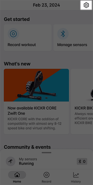

The Audio Alerts feature offers both general and custom spoken alerts that can be set independently for each workout profile at Home > settingsicon.png [Settings] > Workout Profiles > workout profile > Alerts .
Audio Alerts are created and modified for each Workout Profile at the workout profile level.

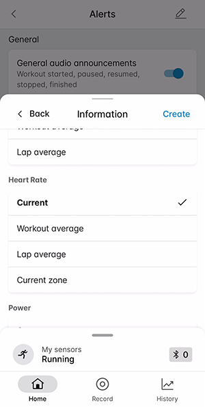

You can choose any single information value (or multiple values) to be played at a given trigger.
Example: Play lap average pace and lap average heart rate when triggered by 1 mile auto-lap intervals.
When an information value is played, it will be presented as information label + information category + information value.
Example: Lap average heart rate 147
If a information value does not have a fixed unit (i.e. distance could be miles or kilometers), the unit will also be played.
Example; Lap total distance 3.2 miles

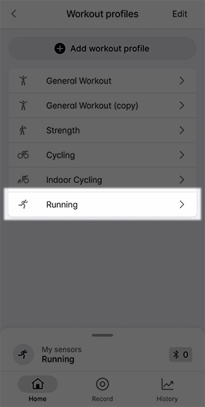

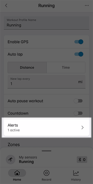

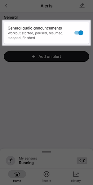

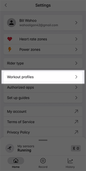

  • General alerts, or custom alerts (once created) can be toggled on/off for each Workout Profile by navigating to Home > settingsicon.png [Settings] > Workout Profiles > workout profile [ex. Running] > Alerts.
  • Home > settingsicon.png [Settings] > Workout Profiles > workout profile [ex. Running] > Alerts.
  • Once in the Alerts submenu, use the toggle to the right of the alert you want to enable/disable. Blue and to the right when on, gray and to the left when off.

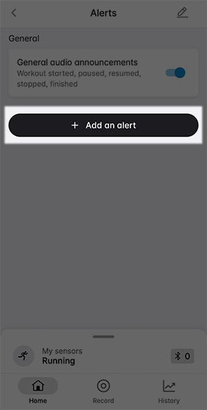

Create a custom alert

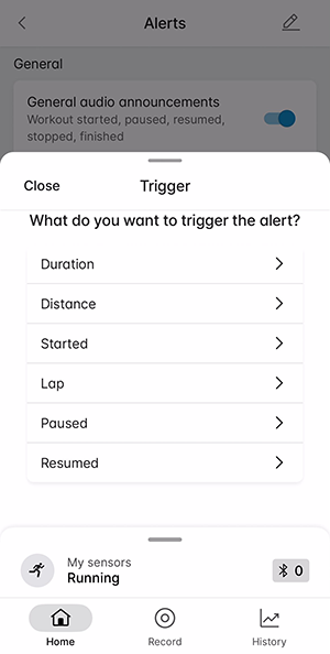

  • Once in the Alerts submenu, select + Add an alert.
  • Select your trigger.

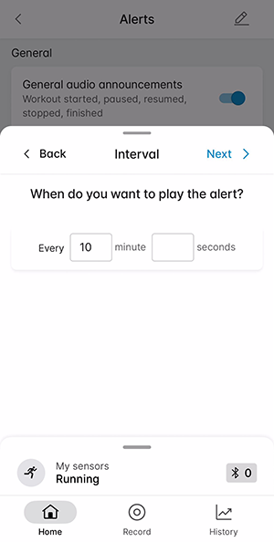

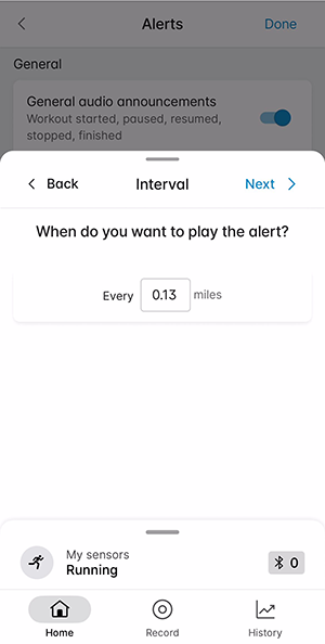

  • If you selected a Duration or Distance trigger, select One time or Repeat.
  • Select your distance or time interval before the first and/or any repeating alerts.
    If using another trigger, interval will not be shown. Skip to the next step.
  • Select one or more information values to be played with that trigger and select Create.

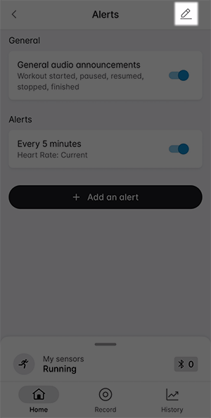

Edit an existing alert
  • Within the Alerts submenu, select the editicon.png  [Edit] button.
  • Select the right facing arrow to the right of the alert you wish to edit.

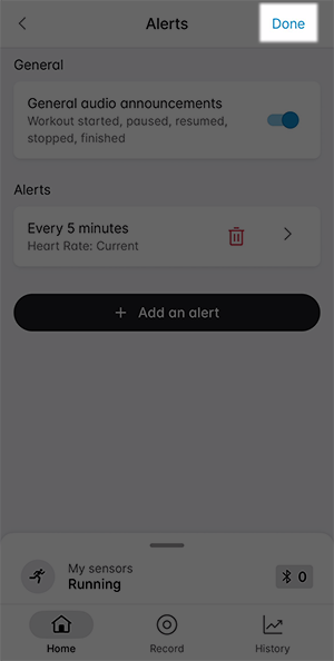

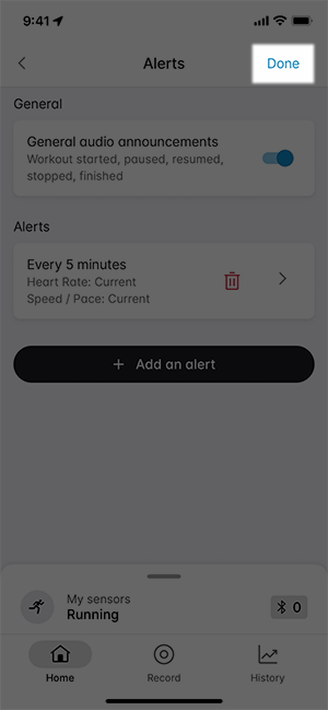

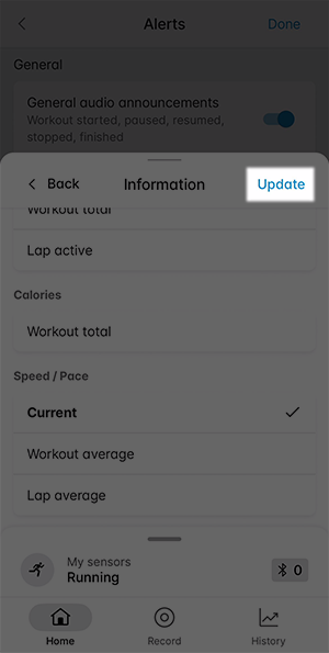

  • Select any existing values to toggle them off and one or more new information values to be played with that trigger and select Update.
  • Select Done in the upper right hand corner.

Delete an alert

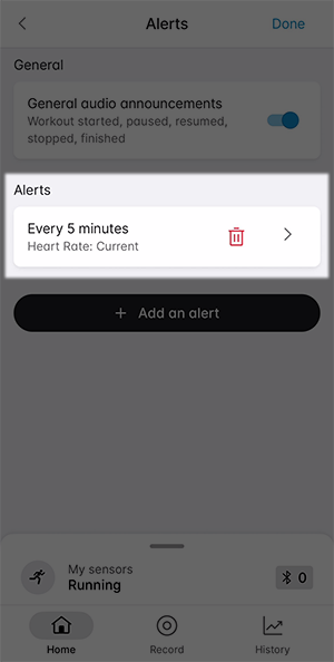

  • Select the deleteicon.png [Delete] button to the right of the alert you wish to edit.
