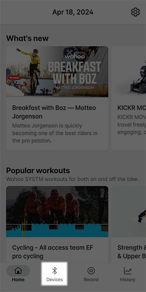

Sensor management [Wahoo app]
All sensor management has moved from the Settings page to the Devices tab. This tab will also pop up when you select the Record tab or can be accessed the Bluetooth button bluetoothicon.png at the top of the Record page once a workout has been started.

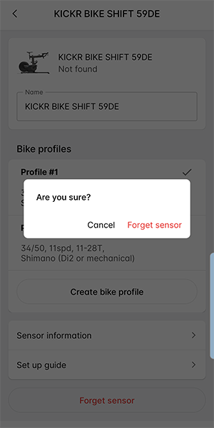

Forget a sensor
Once paired, you can forget or delete a sensor from the app by:
  1. Selecting the sensor in the My sensors list,
  2. Scrolling to the bottom of the sensor details page,
  3. Selecting Forget Sensor, and
  4. Confirming Forget sensor.
sensors-shift-details2-crop-sm.png sensors-forget-sure-crop-sm.png blanktrans300x600.png

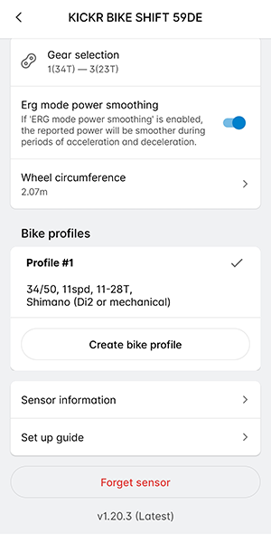

Update sensor firmware
When a sensor is paired, the app will check the sensor's firmware against the firmware server for the current version. If the sensor's firmware is not current, Update available will appear under the sensor name in the Devices tab.
  1. Select the sensor and open the sensor details page.
  2. Update Firmware will appear under the sensor name.
  3. Ensure that the sensor is only connected to the Wahoo app on your phone or tablet (and not also to Zwift, TrainerRoad, or another app on another device) and that your phone is not paired to any other Bluetooth® devices (including headphones or smartwatches) and then
  4. Select Update Firmware and follow directions to update the sensor firmware.
Because the firmware is updated via Bluetooth®, which is a low-bandwidth protocol, please understand the update process will take several minutes.
You can always check the currently installed firmware version by scrolling to the bottom of the sensor details page where the version number and its status -- (Old or Latest) will be listed.

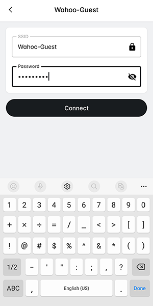

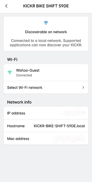

Connect a Wahoo smart trainer/smart bike to Wi-Fi
Once paired, if a sensor is capable of a Wi-Fi connection (KICKR BIKE v2, BIKE SHIFT, KICKR v6, and KICKR MOVE), you will be prompted to connect the trainer to a 2.4Ghz Wi-Fi network for the fastest possible connection to certain third party apps and over-the-air firmware updates.
  1. Select the sensor and the panel labeled Wi-Fi,
  2. Select your compatible 2.4 Ghz network, running on channel 1-9 from the list,
  3. Enter your credentials, and
  4. Select Connect.
Once connected, you can confirm the connection details, change networks, or update network passwords by selecting that Wi-Fi panel again.
sensors-shift-connectwifi-crop-sm.png sensors-shift-wifiavailablenetworks-crop=sm.png sensors-shift-wificredentered-crop-sm.png
sensors-shift-wifidetails-crop-sm.png blanktrans300x600.png blanktrans300x600.png

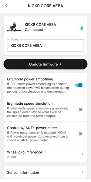

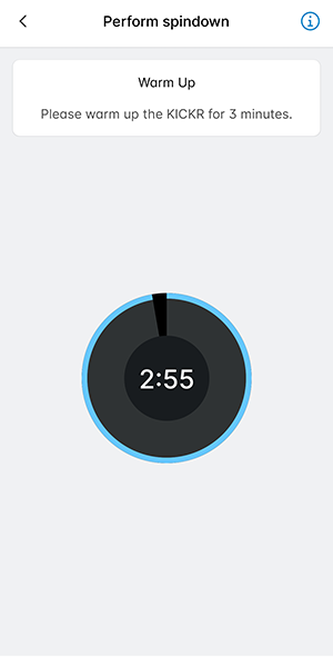

Calibrate a Wahoo smart trainer
For those Wahoo smart trainers (KICKR CORE and KICKR SNAP) that require regular spindown calibrations, the spindown calibration menu is accessed by selecting the Perform spindown button at the bottom of the sensor details page for the trainer in the My sensors list. Just follow the directions on screen.
wad-mydevices-coretickrx-300.png sensors-core-sensordetails2-crop-sm.png sensors-core-performspindown-crop-sm.png

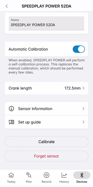

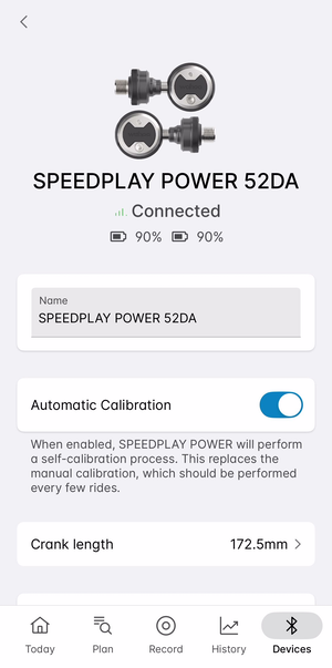

Update firmware on / Calibrate a SPEEDPLAY POWER pedal set
Like other sensors, SPEEDPLAY POWER pedal sets will prompt you to update firmware if they are not currently on the latest version.
  1. Select the pedals in the Devices list and open the sensor details page.
  2. Update Firmware will appear below crank length.
  4. Select Update Firmware and follow directions to update the pedal firmware.
Because the firmware is updated via Bluetooth®, which is a low-bandwidth protocol, and the app has to update both pedals, please understand the process may take several minutes.
You can also toggle Automatic Calibration on or off and manually calibrate the pedals using the Calibrate button at the bottom of the SPEEDPLAY POWER sensor details page.

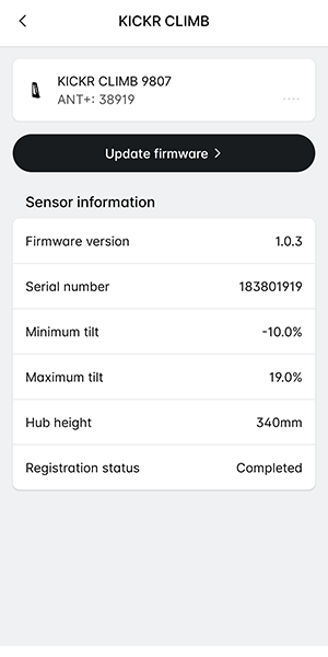

Set up a KICKR CLIMB
To set up a KICKR CLIMB with a compatible Wahoo trainer
    1. First ensure the KICKR CLIMB and smart trainer are plugged in and powered with the blue LED illuminated on the KICKR CLIMB remote.
    2. Press and hold the center lock mode button on the KICKR CLIMB remote for 3 seconds until the center white LED flashes steadily.
    3. Hold the CLIMB's remote near the KICKR or KICKR SNAP until the center white LED flashes quickly, then turns solid. The center white LED remains illuminated and solid while connected and successfully paired to the smart trainer.
Once the CLIMB is paired to the trainer, the CLIMB sensor details, bike wheelbase and tire circumference settings, tilt, and hub height status, and firmware update process are accessed from the trainer's sensor details page in the Devices list.
wad-mydevices-trainersbikes-300.png sensors-move-climb-crop-sm.png sensors-move-climb-sensorinfo-crop-sm.png
