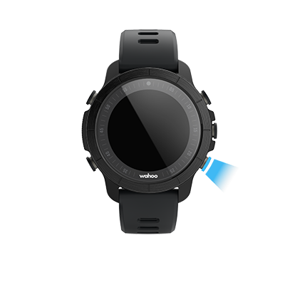

  1. Use the middle right button to select your preferred Workout Profile.
  2. Once a workout profile has been identified (does not require starting), ensure you are on any workout page, other than the primary watch face page.

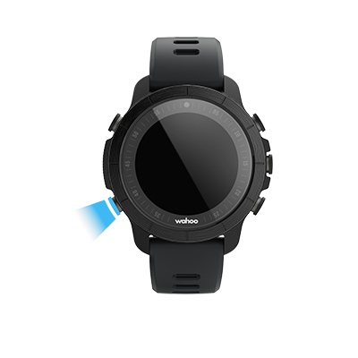

  3. Hold the bottom left button to bring up the main menu, which will now include Target Plan.Rbtn-BL.png

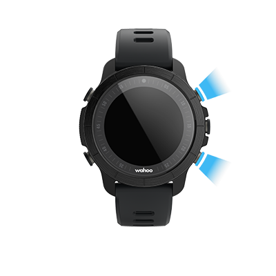

  4. Use the top/bottom right buttons to navigate up to and middle right button to select Target Plan.
  5. Press the middle right button to toggle Target On.
  6. Use the bottom right button to select Set target and the middle right button to enter the Set target submenu.
  7. Within that submenu, use the top/bottom right buttons to toggle between target metrics (HR, pace, power, or cadence) and middle right button to select the metric.
  8. Once the metric is selected, use the top/bottom right buttons to identify the target value and middle right button to select the value.
  9. You can then use the top/bottom right buttons to navigate to the Out of range alerts toggle, and the middle right button to toggle between off, on, sound only, or vibration only.
  10. If kicked out of the target plan menu by a GPS location or other notification, you can re-enter the Target Plan menu by holding the bottom left button.
