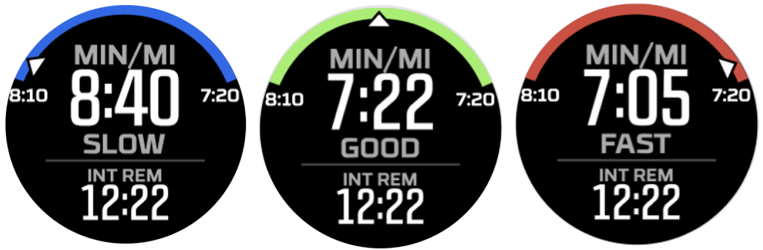

1. Planned Workout Dial
The Planned Workout Dial will give you all the information about your current interval and is not customizable.
Dial Page showing targets and interval remaining
  • The dial at the top of the page will let you know how you are doing compared to your target for the interval. The color of the dial will change between Red, Blue, and Green depending on if you are above, at, or below your prescribed effort. If your workout plan is based on a range, you will also see an arrow in the dial indicating where your effort is in that range.
  • Current values will be displayed under the dial depending on the target values of the workout plan. These values will show a smoothed value for Watts, HR, or Pace.
  • Another indicator of how well you are doing against the current target is given below the current value by indicating that you are HIGH/FAST, GOOD, or LOW/SLOW.
  • Interval remaining lets you know how long is left in the current interval. For distance-based workout plans, this will show the distance remaining using the metrics of the workout plan (miles, kilometers, meters, yards, etc).

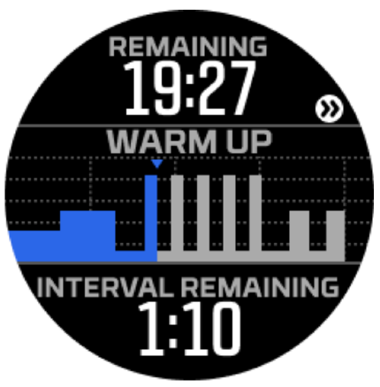

2. Planned Workout Graph:
The Planned Workout Graph shows the workout graph and scrolls based on what you’ve completed.

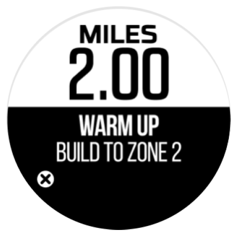

While on this page, you can skip to the next interval in the plan by pressing the lap button. There are two customizable data fields on this page.
Skipping Intervals
At any point during a planned workout, you can skip the current interval and immediately start the next interval by pressing the lap button (top right, by defualt). This will show a popup of the next interval details as programmed into the Planned Workout and start the new interval.
Next interval popup

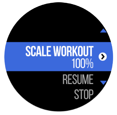

Scale, Pause or Stop a Planned Workout
Once a Planned Workout is loaded on ELEMNT RIVAL, hold the menu button (bottom left, by default) to show the three options available below:
Scale, Pause/Resume and Stop Menu
  • Scaling a Workout: By default, plans are loaded on ELEMNT RIVAL at 100% scale. Depending on your preference, the workout can be scaled above or below 100% and targets will be adjusted accordingly. Once the Scale option is selected, you can use the top right and bottom right buttons to scale the workout up or down. Pressing the middle right button will save your selection while the bottom left button will cancel any changes and return to the menu screen.
  • Pausing a workout: Selecting Pause will pause the planned workout, but continue recording the activity. Return to this menu and select Resume to pick up the planned workout where you left off.
  • Stopping a workout: Selecting Stop will end the planned workout, but the activity will continue to record.

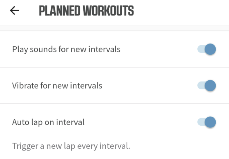

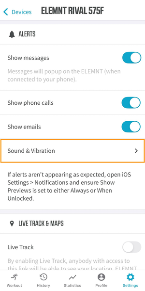

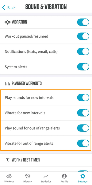

In the ELEMNT app, there are some additional options for Planned Workouts. These options include:
  • Play sounds for new intervals
  • Vibrate for new intervals
  • Play sound for out of range alerts
  • Vibrate for out of range alerts
By default, these options are enabled, but can be disabled in Settings > Sound
Planned Workouts with Track Running
Planned Workouts can be used in conjunction with Track Running. However, the lap snapping function for Track Running is not available as the lap button is used for progressing intervals of the Planned Workouts. We recommend ensuring the Auto Lap on interval option is toggled on for using Planned Workouts with Track Running to ensure ease of data evaluation post workout.
