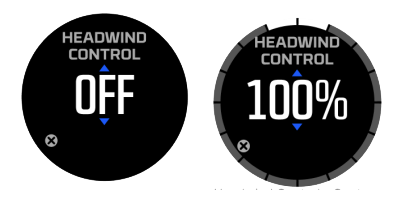

Direct Control
Once paired, the Headwind will default to Direct Control mode, allowing you to adjust fan speed from 0-100% in 25% increments. Use the pair of buttons you have chosen for the zoom function (bottom left + right, bottom left + top right, or top left + bottom right) to open the adjustment menu and then use the top or bottom right buttons to increase or decrease the fan speed. Press the bottom left button to exit the submenu or the Control menu entirely.
