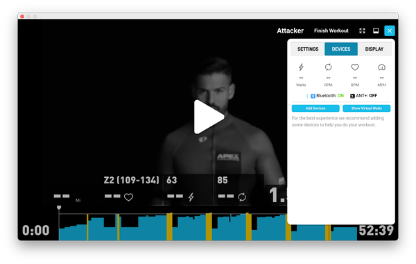

Select your workout from the Library and press the Start Workout button.
This will launch the Device Connections screen.  If your screen does not open automatically, please tap the gear icon in the top right corner of your page.  Please ensure that your screen says that Bluetooth is ON.
Activate your sensors, then click the Add Devices button on your screen.  Cadence sensors and speed sensors will require you to spin the cranks; heart rate monitors will require you to be wearing them.  Moistening the leads on the heart rate monitor strap can help if your sensor doesn't appear in the device list.

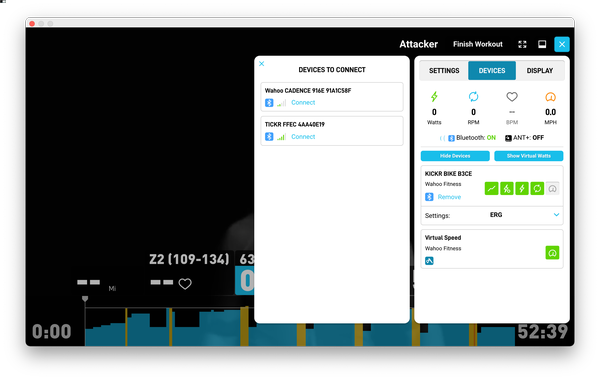

Selecting and Connecting your Sensor
Clicking on the Add Devices button will open a second panel on the Device Connections screen.  Please find your sensor on the list of devices to connect. All the available sensors will appear here.  If your sensor is compatible but does not appear in this list, please ensure that it is not connected to another app or device.  Find your sensor and click Connect.  You can select and connect to all your sensors from this panel.

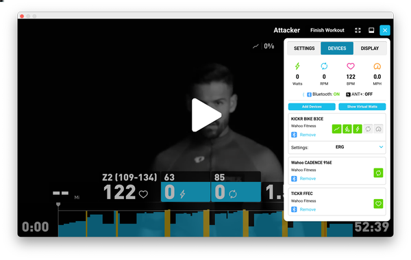

The sensor connections should now appear in the right-hand panel of the Device Connections box.  Once the sensor connection is established, the box for that connection should turn white.  The icons may be green (ON) or white (OFF)
cadence_icon.pngThis is the Cadence Icon.  Please select this icon to display cadence in the app.  Cadence can come from a cadence sensor, a combined speed and cadence sensor, a power meter, or an internal sensor in a smart trainer.
speed_icon.pngThis is the Speed Icon.  If you are using Virtual Watts, you will need to connect this sensor first.  If you are connecting a smart trainer, there is no need for a speed sensor connection.  For more information, see the following article:  Understanding Virtual Speed Calculations.
heartrate_icon.png This is the heart rate icon.  Please select it to display the heart rate from this sensor to the app.
