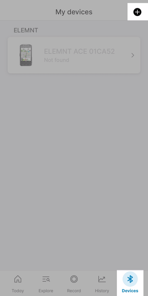

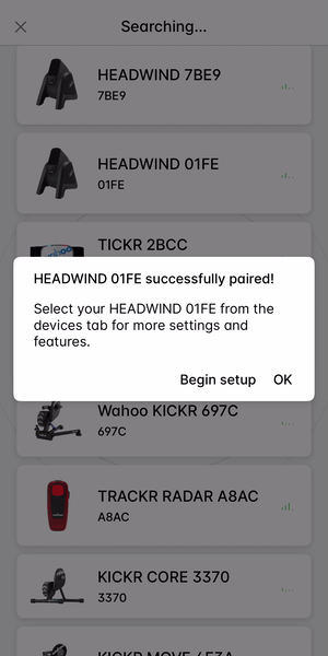

  1. With the KICKR HEADWIND plugged in and Bluetooth® enabled on your mobile device, open the Wahoo app.
  2. Navigate to the Devices tab.

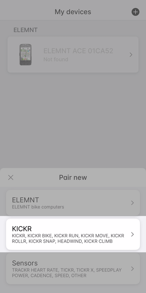

  3. Select the + sign. Select KICKR for adding a HEADWIND.
    wa-devices-addnew-300.png wa-devices-addnew-kickr-300.png wa-devices-searching-headwind-300.png

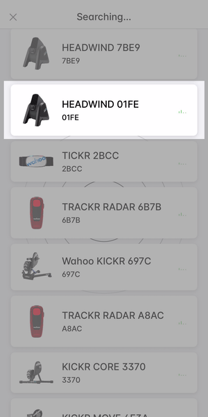

  4. Select the HEADWIND from the list.

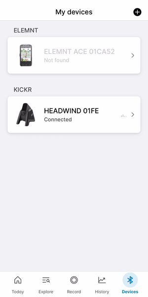

  5. The HEADWIND is paired.

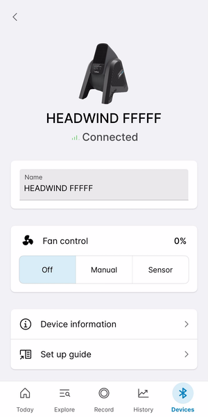

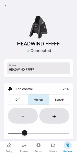

  1. To control airflow, open the Devices tab and select the HEADWIND.
    wa-devices-headwind-connected-300.png blanktrans300x600.png blanktrans300x600.png
  2. Under Fan Control, the HEADWIND will default to Off, or whatever state it was in when turned on.  To manually control the HEADWIND in the app, select the Manage tab and manually adjust intensity using the slider.
    wa-hw-details-connected-300.png wa-hw-connected-manual-300.png blanktrans300x600.png

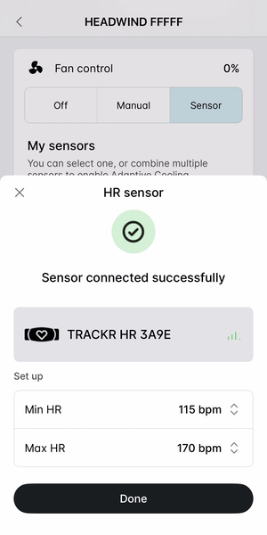

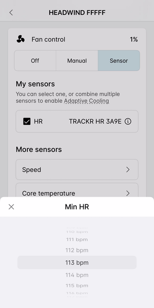

    3. Select HR, Speed, core temperature, run pace or power for control from a heart rate monitor, speed sensor, core temperature reader, foto pod or trainer that has been paired to KICKR HEADWIND following these instructions.*
    wa-hw-sensors-hr-paired-300.png wa-hw-sensors-hr-minhr-300.png blanktrans300x600.png
    *KICKR HEADWIND must be directly paired to a sensor to receive heart rate or speed data.
