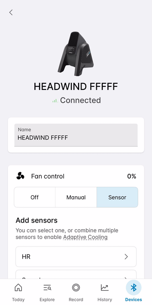

  2. Navigate to the Devices tab. Select your HEADWIND.

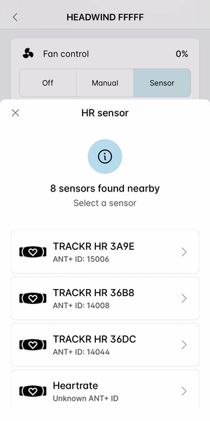

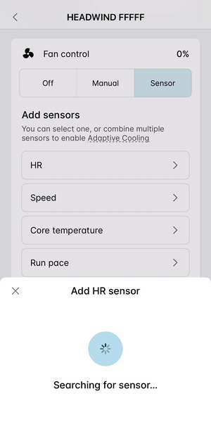

  4. Select the type of sensor you wish to pair. The sensor search will identify any nearby Bluetooth or ANT+ sensor.
  5. Select the sensor you wish to pair from the list that appears.

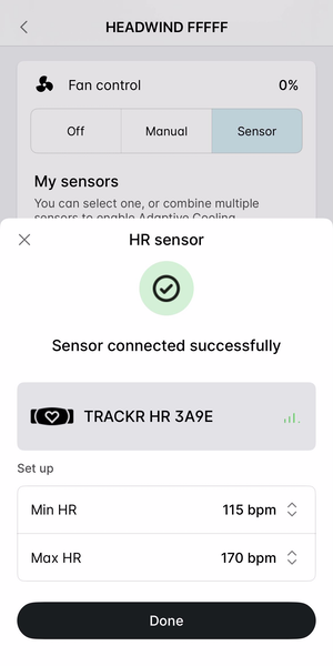

  6. You can now modify the Min/Max fan speed thresholds for that sensor mode, or select Done.

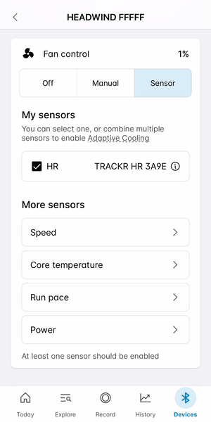

Wahoo app HEADWIND screen with Fan control on Sensor and the Add sensors list starting with HR
Wahoo app HEADWIND Add HR sensor panel showing Searching for sensor Wahoo app HEADWIND HR sensor panel listing 8 sensors found nearby to choose from

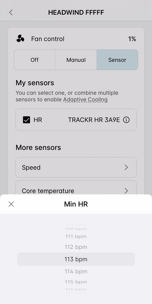

Wahoo app HEADWIND HR sensor panel saying Sensor connected successfully, with Min HR and Max HR settings Wahoo app HEADWIND Sensor mode with an HR sensor checked under My sensors and more sensor types below Wahoo app HEADWIND Min HR picker set to 113 bpm

  4. Select Min threshold value to change the value above which the fan will begin blowing or Max threshold value to change the value at which the fan will reach 100% fan speed. The HEADWIND will blow at 100% for all values above the max value selected.

To enable adaptive cooling, use the same pairing process as above. Once an additional sensor is paired, check/uncheck which sensor you want enabled with the HEADWIND and set your thresholds accordingly.
