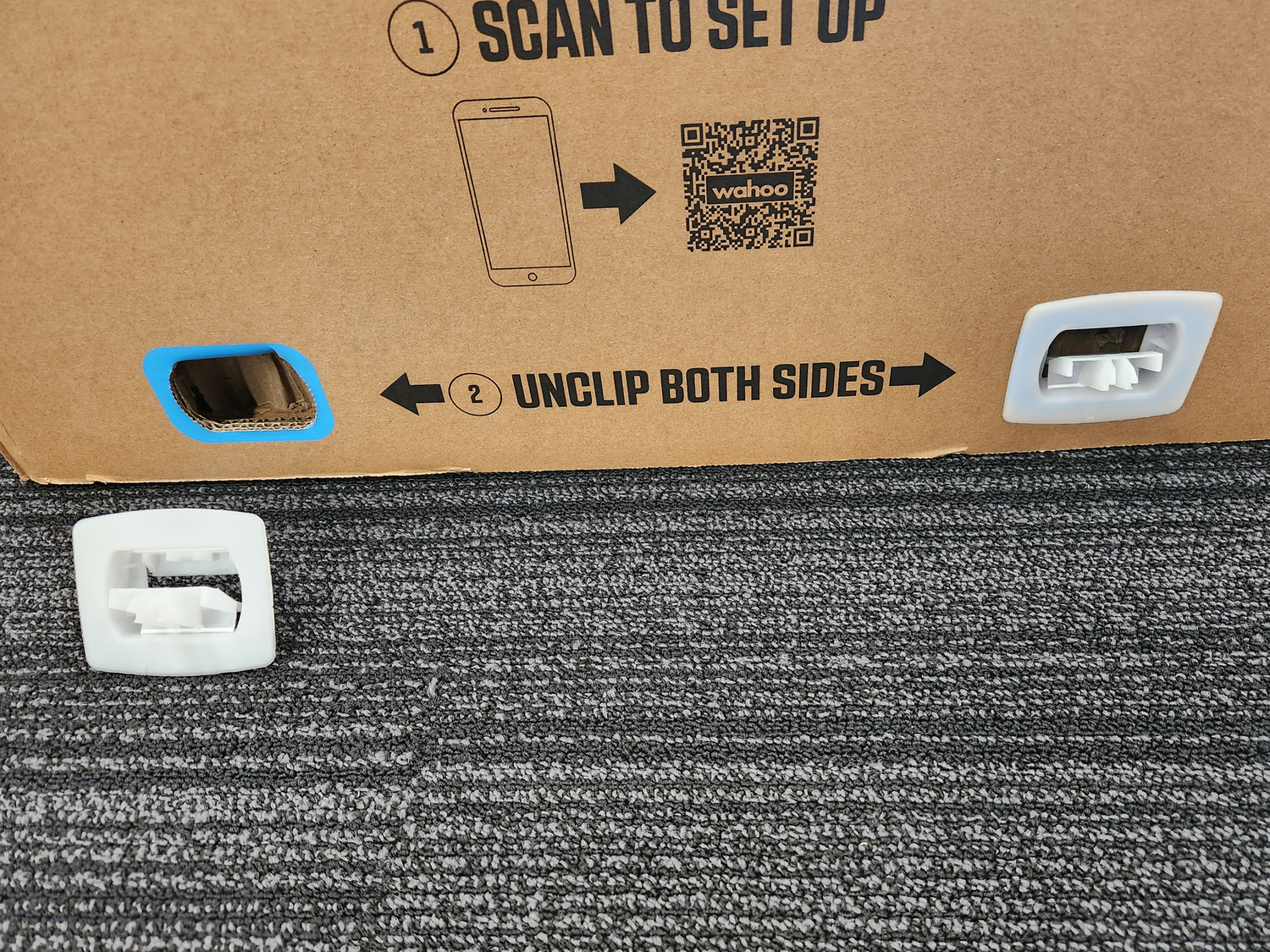

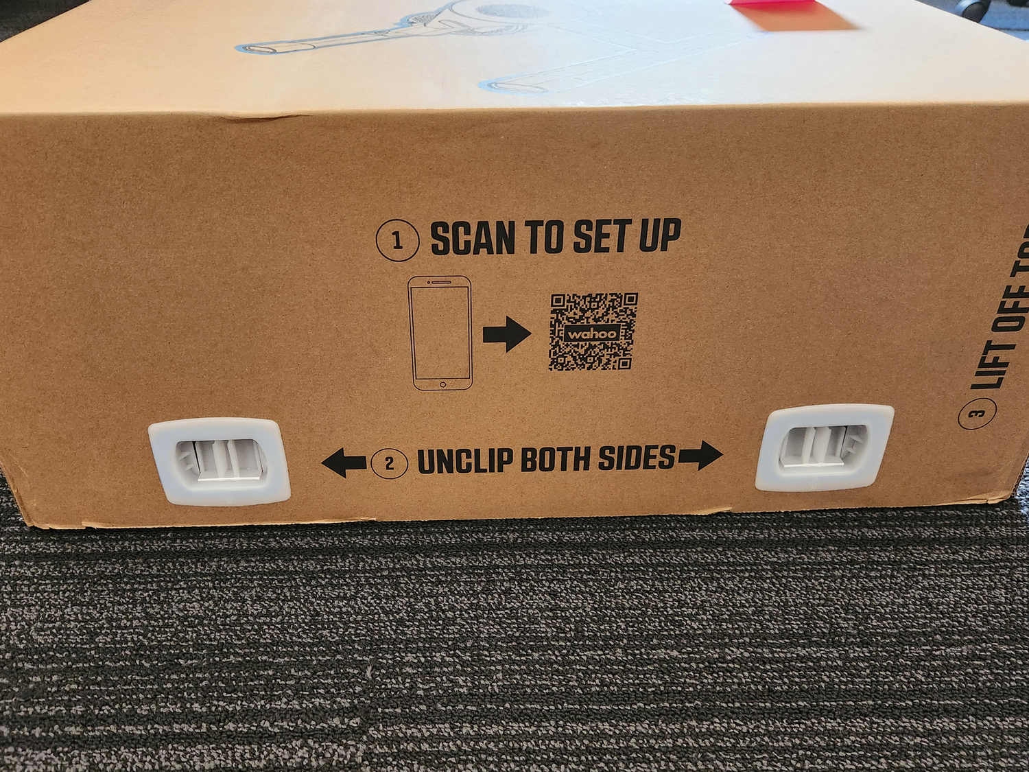

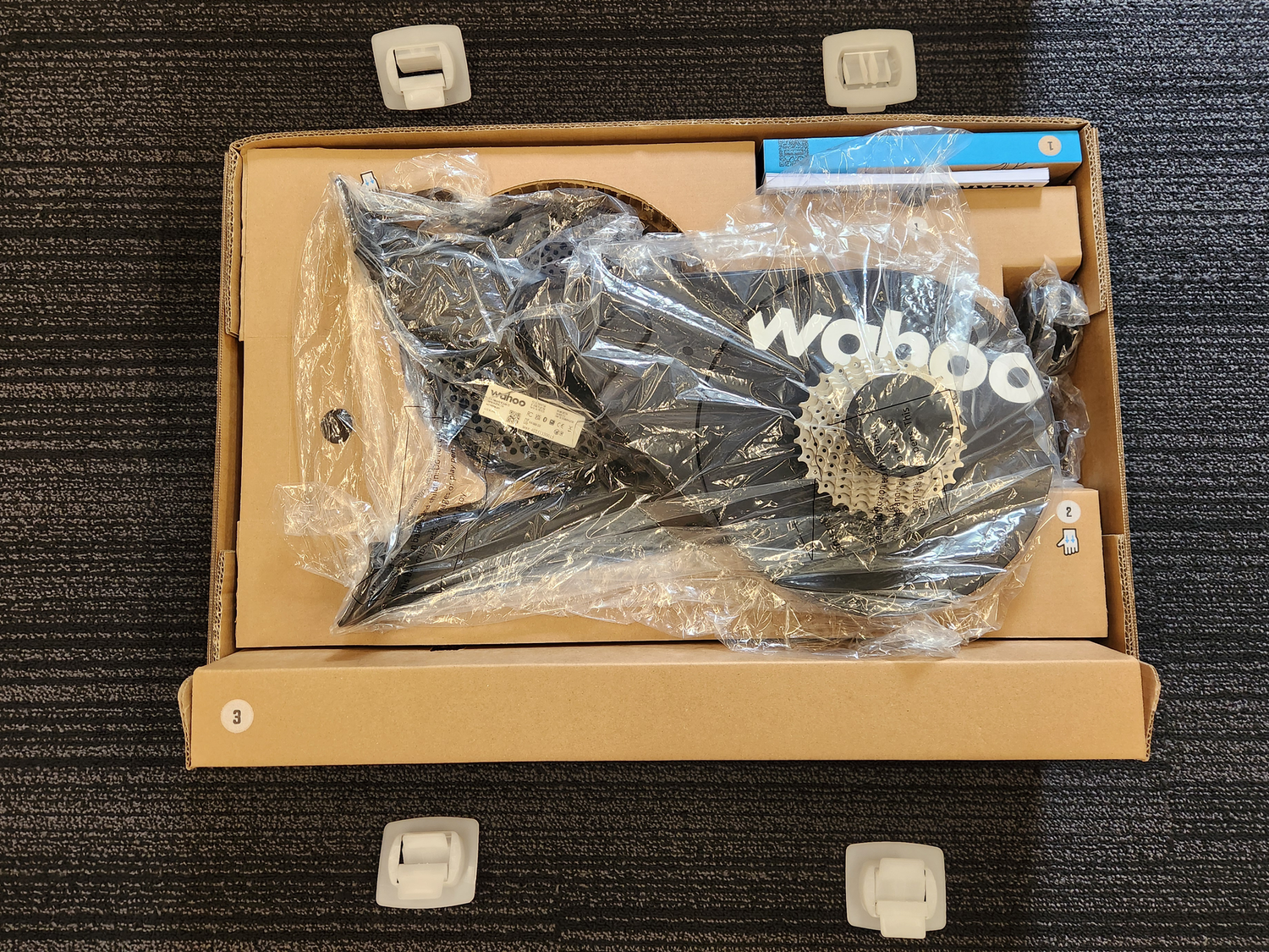

  1. Begin with the front of the box facing upward. The front is labeled with a large #1 and a scannable QR code for setup instructions.
  2. Pinch clips and gently pull outward.
  3. Pull clips outward and down.
    Side of the KICKR CORE 2 box: 1 Scan to set up QR code, 2 Unclip both sides, with two plastic clips Box side with one plastic clip pulled out and lying on the floor, the other still in place
  4. Repeat for all clips on the box (four total).
  5. With clips removed, pull box top up/off.
    Top of the KICKR CORE box with plastic clips removed and set beside it Open KICKR CORE 2 box showing the wrapped trainer, the #1 adapters card and the #3 legs box
  6. Remove #1 adapters card + manual, #2 trainer, #3 legs box, and power adapter and cord from boxes/plastic.
    KICKR CORE 2 unpacked: trainer, two legs, adapters card, manual, power adapter and cord, clips and packaging

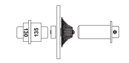

130MM or 135MM Quick Release (QR)
An axle adapter is required on both sides of the KICKR.
Diagram of quick release adapters A and B fitted on either side of the trainer, B marked 130 and 135
  • Adapters A + B are required.
  • Note the asymmetry of adapter B. When used with a 130mm bike, the longer side of the adapter should be inserted into the trainer. When used with a 135mm bike, the shorter side should be inserted into the trainer.
  • Insert the skewer into the wide end of one spring, then into Adapter B, then into the trainer from the non-drive (left) side.
  • Slide the longer end of Adapter A around the skewer and into the trainer from the drive side.
  • Slide the narrow end of the remaining spring over the skewer, then thread the wider end of the acorn nut onto the skewer.

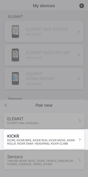

Pair to the Wahoo App

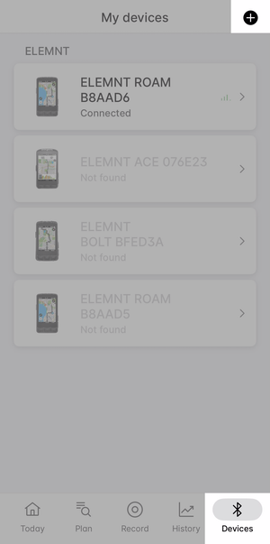

  1. Open the Wahoo app.
  2. Navigate to the Devices tab.
  3. Select Pair sensor (or the + sign if another sensor is paired).
  4. Select the KICKR CORE.
    Wahoo app My devices screen with the + button at top right and the Devices tab highlighted Wahoo app Pair new menu with the KICKR option highlighted Wahoo app Searching for sensors list with KICKR CORE 2D91 highlighted
  5. The CORE is now paired!

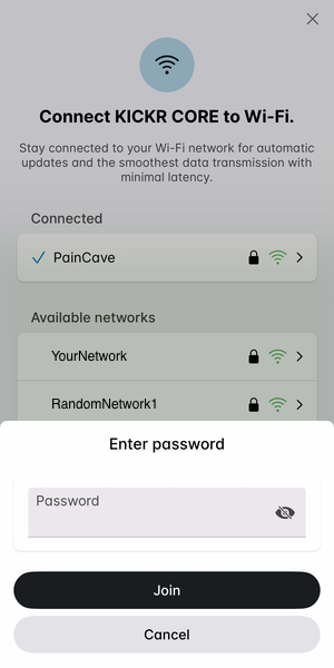

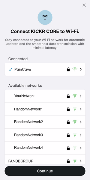

WiFi Setup
Once paired, the Wahoo app will prompt you to proceed into Wi-Fi setup to allow for automatic firmware updates and the most robust connection available for third party desktop or Apple TV applications. Please see our WiFi support page for more details.
Wahoo app Connect KICKR CORE to Wi-Fi screen listing available networks and a Continue button Wahoo app Wi-Fi setup with the Enter password field and a Join button

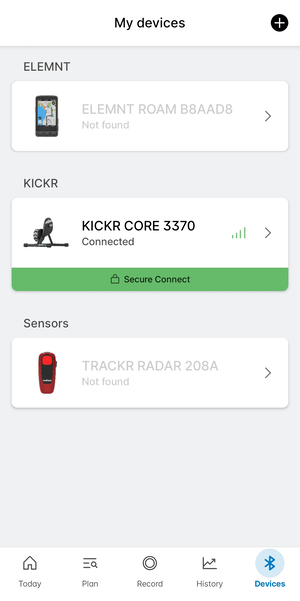

Wahoo app screen: Your KICKR CORE is up to date, v3.0.24, with a Finish setup button
Wahoo app on iOS: My devices with KICKR CORE 3370 Connected under KICKR
Wahoo app on Android: My devices with KICKR CORE 3370 Connected and a Secure Connect banner
