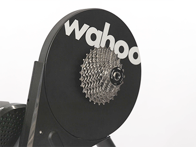

  1. Remove the quick release and drive side QR adapter or thru axle spin cap, if present.
    KICKR CORE drive side with a cassette installed and the spin cap removed

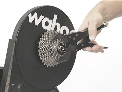

  2. Secure the chain whip, cassette vise, or pliers around a cog in the middle of the cassette with the handle(s) toward the front of the cassette. If using a chain whip, drape the chain over the top of the cassette from back to front. This will allow you to apply downward force on the tool to prevent the cassette spinning backward when loosening the lock ring.
    Cassette pliers gripping a middle cog of the cassette on KICKR CORE, handles toward the front

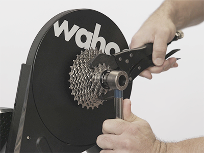

  3. Insert the cassette lock ring tool into the cassette lock ring fully, and secure the wrench to the lock ring tool.
    Cassette pliers bracing the cassette while a lock ring tool and handle loosen the lock ring
  4. Push or pull the cassette lockring tool counter-clockwise while using the chain whip or cassette vise/pliers to brace cassette in place. You will hear a ratcheting/notching noise as the lock ring breaks free.

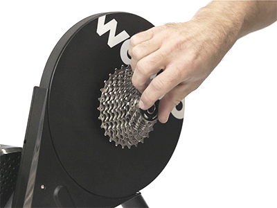

  6. When the lock ring is gone, gently pull the cassette outward with both hands, noting that the cogs will be loose when free of the freehub body. Having a zip tie handy to loop through a cassette to ensure the order of the cogs is maintained can be helpful.
    Both hands sliding the loose cassette straight off the KICKR CORE freehub body

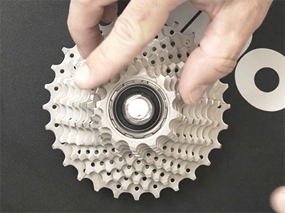

  1. 11 speed cassettes and 12 speed road cassettes do not require a spacer.
    7-10 speed cassettes require additional spacers.
    • 8, 9, and 10 speed cassettes will require a 1.8mm spacer (included with new trainers).
    • 7 speed cassettes will require the 1.8mm spacer AND a 4.5mm spacer (to be purchased separately from your preferred local or online retailer).
  2. If your new cassette includes an additional spacer (ex. 1mm spacers with Shimano 10 speed road cassettes), install this before installing the cassette. Otherwise, install the new cassette. directly.

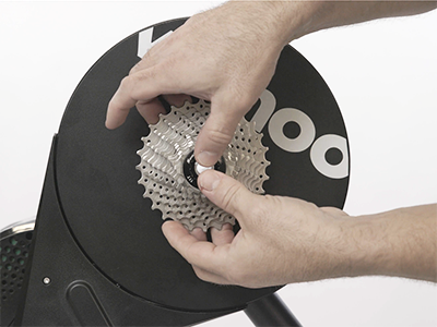

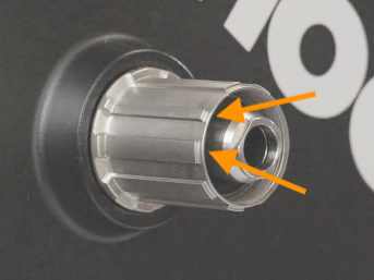

  3. Examine the freehub body and note the location of the one spline that is narrower than the others. This keyed pattern exists on the inside edge of the cassette cogs and ensures that the cassette can only be installed one way. Rotate the narrow spline to the top and then install cogs and spacers as a group or one by one, ensuring that the cogs are installed large to small.
    KICKR CORE freehub body with arrows pointing to the narrow keyed spline Hands sliding cassette cogs onto the freehub, aligning the keyed spline

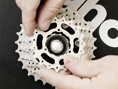

  4. If you drop any cogs or spacers, know that
    • Cogs can only be installed one way.
    • Some of the rearmost cogs may be pinned together or mounted on a carrier as a group.
    • All spacers are identical, interchangeable, and reversible.
    • Generally, there should be a spacer between each cog, except for the last few, where each has a built-in spacer. You will see that they have a thicker profile.
