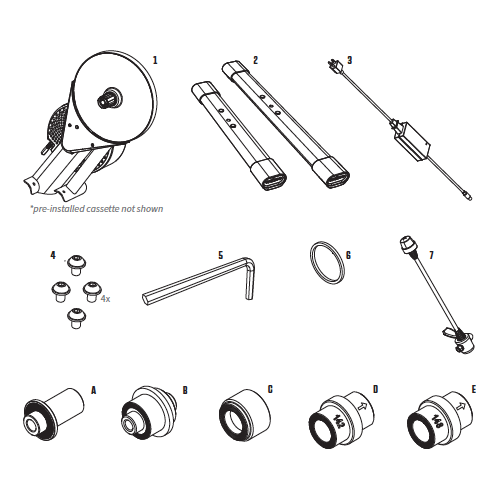

In the Box
- KICKR CORE 2 Smart Trainer
- Front/Rear Leg Assembly (Longer/shorter leg)
- AC power adapter (plug will vary depending on region and location)
- Bolts for leg assembly (x4)
- 6mm hex tool
- 1.8mm spacer (included with cassette version only)
- Quick release (QR) skewer
Included adapters:
A. Quick release drive-side adapter
B. Quick release non drive-side adapter
(reversible for 130/135mm)
C. Thru axle drive-side adapter
D. Thru axle 12x142mm non drive-side adapter
E. Thru axle 12x148mm non drive-side adapter
*Caution: Use of third party power adapters not supplied by Wahoo Fitness may cause permanent damage to your trainer.
*Note: KICKR CORE 2 Smart Trainer for the Zwift Ride (SKU: WFBKTR125-3CR) only includes items 1-5 and adapters C and D.
