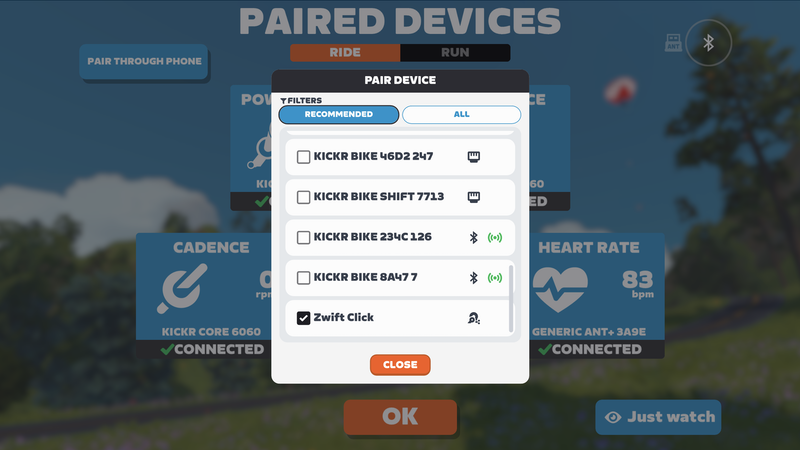

For Zwift, a heart rate monitor and/or compatible Zwift controllers* can be bridged through the trainer or BIKE using the Zwift game pairing screen. The Zwift game ignores the heart rate monitor stored in the trainer/BIKE's firmware, but once a CORE 2 or BIKE PRO on current firmware is selected in the Zwift pairing screen, Zwift will have the trainer search and bridge any available compatible heart rate monitors and/or Zwift controllers.  The desired heart rate monitor can then be selected in the heart rate data source pairing screen by selecting the name of the heart rate monitor with the trainer icon beside it.  The same can be done with a compatible controller set.

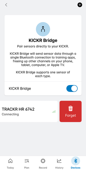

Pair a heart rate monitor to the KICKR Bridge
  1. Download the Wahoo App.
The Wahoo app keeps your trainer up to date and leverages your smartphone to record basic workout information, delivering data-driven power that fuels your training and fitness goals. Get the app now to register your KICKR CORE.

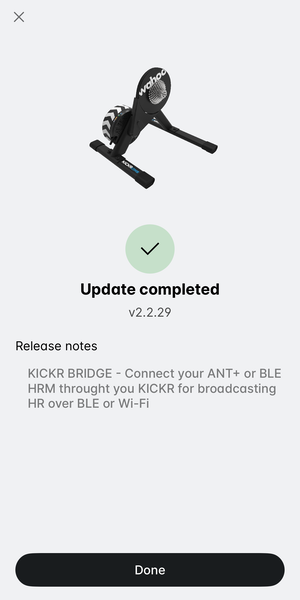

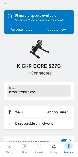

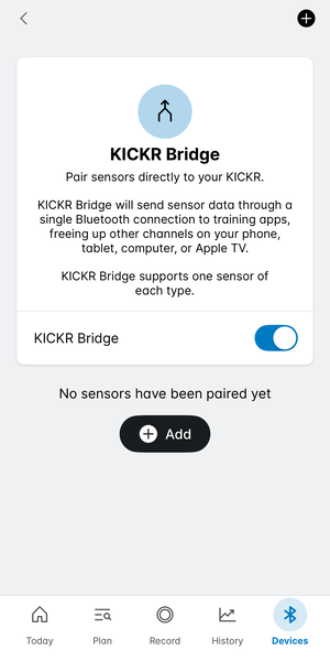

2. Connect your KICKR CORE 2 or KICKR BIKE PRO to the Wahoo App.

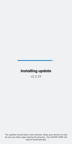

3. Make sure your trainer's firmware is up to date.
4. Make sure the heart rate monitor you wish to pair is nearby, awake and ready for pairing.

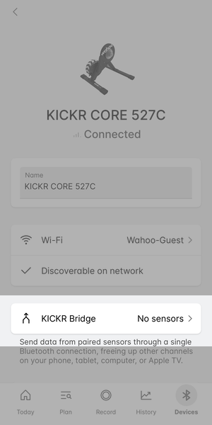

5. Select the KICKR CORE 2 or KICKR BIKE PRO from your devices list.

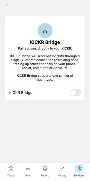

6. Select KICKR Bridge on the trainer details page.

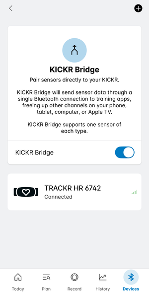

7. Toggle the KICKR Bridge 'ON'.

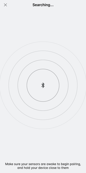

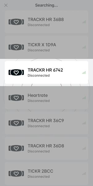

6. Select Add Sensor and pair your desired sensor.
Your heart rate monitor is now paired to the CORE 2 or BIKE Pro via the KICKR Bridge. When you're ready to train, simply put on your heart rate monitor and select the trainer or BIKE as the heart rate data source in your desired fitness application and the heart rate data will appear in app.

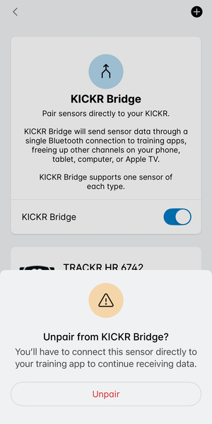

Unpair a sensor from the KICKR Bridge
  1. Connect your CORE 2 or BIKE PRO to the Wahoo App.
  2. Select the trainer or BIKE from your Devices list.
  3. Select KICKR Bridge on the trainer details page. Select the heart rate monitor you want to unpair.
4. Confirm you want to unpair. The device is now unpaired from the KICKR Bridge.

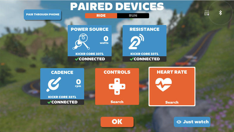

Connect a bridged heart rate monitor or controllers to Zwift
As described above, the Zwift game does not use the heart rate monitor stored in the CORE 2 / BIKE PRO's firmware as described above. Completing the process above for use with other apps will not interfere with Zwift, so there is no reason to avoid pairing a heart rate monitor as described above.
To connect a heart rate monitor and/or compatible controller set to the Zwift game via a CORE 2 / BIKE PRO KICKR Bridge:
  1. Ensure your CORE 2 / BIKE PRO's firmware is up to date by pairing it to the Wahoo app.
    CORE 2 -- 2.5.4 or 3.5.4, BIKE PRO -- 3.2.14.
  2. Once updated, ensure your Zwift game is updated to at least version 104 or higher.
  3. Ensure that your preferred heart rate monitor is installed and awake.

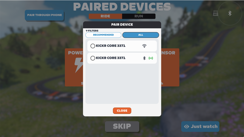

  4. Plug in the CORE 2 / BIKE PRO and pair it to the Zwift game as a power source. If the device you are running the Zwift game on is Wi-Fi enabled and your Wi-Fi is stable, we would suggest pairing the trainer / BIKE via Wi-Fi.

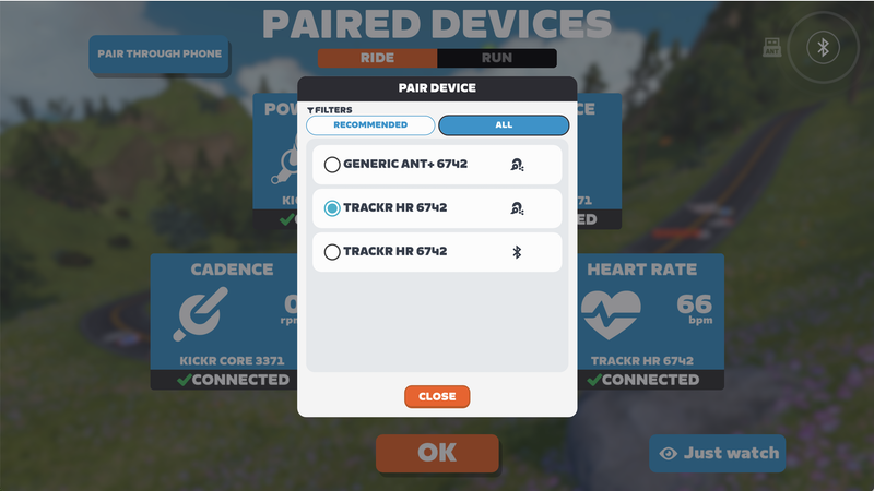

  5. Select the heart rate data source pairing menu.
  6. Look for your heart rate monitor's Bluetooth or ANT+ ID with a trainer icon beside it, rather than the normal Bluetooth or ANT+ symbol. Then select Close.
  7. Select the controllers data source pairing menu and select your Zwift Click v2 or Ride controllers with a trainer icon beside them, rather than the normal Bluetooth or ANT+ symbol. Then select Close.
    Compatible Zwift controllers can only be bridged using the Zwift game pairing screen.  Zwift controllers may appear in the sensor discovery screen of the KICKR Bridge in the Wahoo app, but cannot be added there. Already bridged Zwift controllers may also appear here, but cannot be removed or added in the Wahoo app interface. Manipulating them here may damage the connection in Zwift. If manipulated in the Wahoo app, the Wahoo app should be force closed, the trainer unplugged for 30 seconds, and then the connection re-established in the Zwift game.
