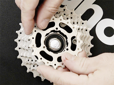

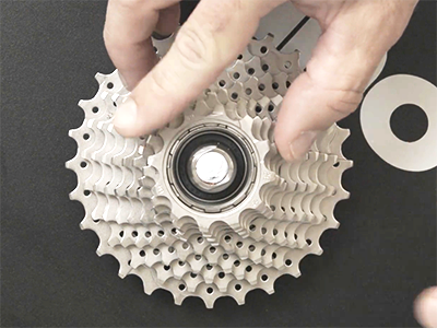

  3. Examine the freehub body and note the location of the one spline that is narrower than the others. This keyed pattern exists on the inside edge of the cassette cogs and ensures that the cassette can only be installed one way. Rotate the narrow spline to the top and then install cogs and spacers as a group or one by one, ensuring that the cogs are installed large to small.
  4. If you get rid of or "drop" any cogs or spacers, know that:
    1. Cogs can only be installed one way.
    2. Some of the rearmost cogs may be pinned together or mounted on a carrier as a group.
    3. All spacers are identical, interchangeable, and reversible.
    4. Generally, there should be a spacer between each cog, except for the last few, where each has a built-in spacer. You will see that they have a thicker profile.
  5. Ensure that the last cog is installed in the correct orientation relative to the key spline, and remains there as you install the lock ring. It can sometimes be difficult to keep it in place during installation. This cog moving during lock ring installation is often the cause of drivetrain noise or cassette instability as it is compressed into the freehub without properly compressing the cogs behind it.

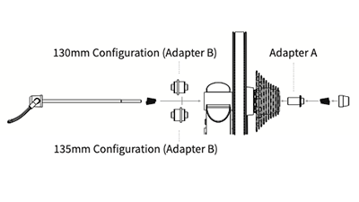

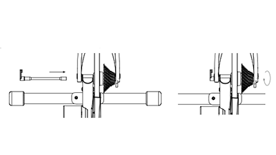

For 130 or 135mm Quick Release (QR)
  • Adapters A + B are required.
  • Note the asymmetry of adapter B. When used with a 130mm bike, the longer side of the adapter should be inserted into the trainer. When used with a 135mm bike, the shorter side should be inserted into the trainer.
  • Insert the skewer into the wide end of one spring, then into Adapter B, then into the trainer from the non-drive (left) side.
  • Slide the longer end of Adapter A around the skewer and into the trainer from the drive side.
  • Slide the narrow end of the remaining spring over the skewer, then thread the wider end of the acorn nut onto the skewer.

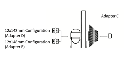

For 12 x 142 or 148mm Thru Axle (TA)
  • Adapters C + D or C + E are required.
  • Note the 142 and 148 labels and directional arrows etched on Adapters D and E. When installing a 12x142mm bike, insert Adapter D into the non-drive (left) side of the trainer, with the arrow facing toward the trainer. When installing a 12x148mm bike, insert Adapter E into the non-drive (left) side of the trainer, with the arrow facing toward the trainer.

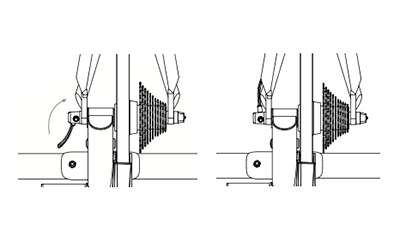

  5. If using a Quick Release (QR):
    • Secure your bicycle by tightening the quick release nut and then closing the quick release lever, clamping the frame. The quick release lever is “open” when it curves away from the bicycle frame. The lever is “closed” when it curves towards the bicycle frame. The handle of the quick release skewer should always be installed on the non-drive (left) side of the KICKR CORE.
    • Failure to properly tighten the quick release skewer may result in property damage or personal injury. If you are unsure of the proper tension, please consult your local bike shop or reach out to our customer support team for guideance. Do NOT ride the CORE until the quick release skewer is tightened.
  6. If using a Thru Axle:
    • Secure your bicycle by reinstalling your bicycle's thru axle to the bicycle manufacturer's specifications.
    • Failure to properly tighten the thru axle may result in property damage or personal injury. If you are unsure of the proper tension, please consult your local bike shop or the bicycle manufacturer for guideance. Do NOT ride the CORE until the thru axle is tightened.

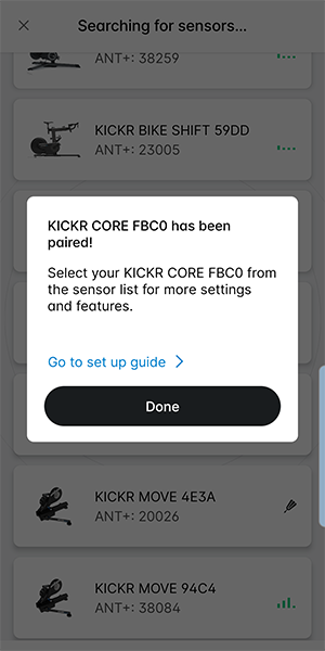

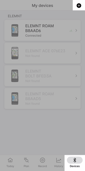

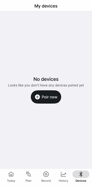

Pair to the Wahoo App
    1. Open the Wahoo app.
    2. Navigate to the Devices tab.
    3. Select Pair sensor (or the + sign if another sensor is paired).
wa-devices-addnew-300.png wa-devices-pair-300.png wa-device-pairkickrtype-300.png
4. Select the KICKR CORE.
5. The CORE is now paired!

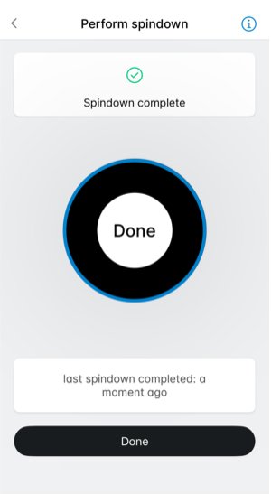

Perform a Spindown on Your CORE
To calibrate your CORE for the most accurate readings, we suggest doing a manual spindown calibration upon initial setup, or after physically transporting your CORE to a different location. Auto spindown calibrations will take care of incremental wear on the trainer. Spindown calibrations should be completed after the trainer has warmed up, at a minimum of 10 minutes of use, or ideally after your workout.

  3. After selecting your Wahoo trainer, the sensor details page is displayed. Wait a moment for your trainer to fully connect, then scroll to the bottom of the page and select the Perform Spindown button.
    Note: a Bluetooth connection is required
  4. Follow the instructions provided in the app. For maximum accuracy, do not pedal once the target speed displayed is reached.
    CORE-spindownfollowdirections-selection-crop-sm.png blank300x10.png blank300x10.png

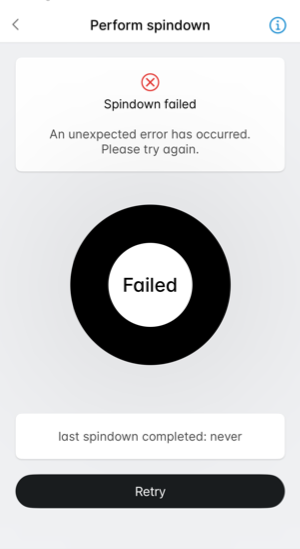

  5. The spindown will complete once the flywheel slows down on on its own. Unless a failure has been indicated, the calibration has been successful. If a failure is indicated, please ensure that all other devices are off and apps are closed and closely follow directions on screen again.
