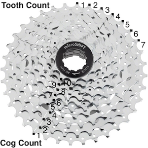

A bicycle's drivetrain compatibility with a KICKR, CORE, or MOVE wheel-off smart trainer requires that a cassette to be used on the trainer is compatible with:
  1. your bicycle's drivetrain in:
    1. cassette cog count (how many cogs/gears are on the cassette),
    2. cassette min/max tooth count (how many teeth on the smallest and largest cogs), and
    3. in some cases, your drivetrain's brand/subtype (as some brand chains/derailleurs will only interface properly with that brand's cassettes in a specific drivetrain system, eg. SRAM Flattop chains).
  2. the trainer's freehub body (the component of the trainer, or a wheel, onto which the cassette is mounted).
Using a cassette incompatible with your bicycle’s drivetrain can result in damage to the cassette or other parts of your drivetrain.
