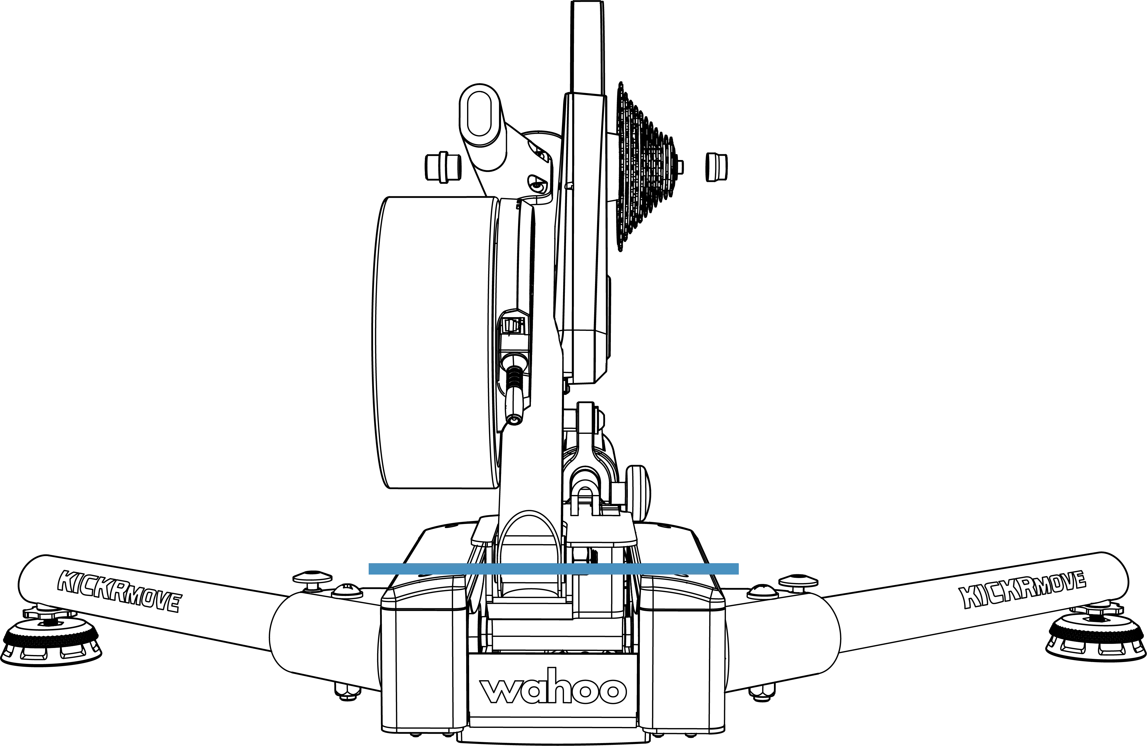

  1. Start by leveling the KICKR MOVE’s base relative to the floor by loosening the blue locknut of the AXIS foot on a side stabilizer leg and then threading the foot out/in to raise or lower that side before tightening the locknut to lock the AXIS foot height.
  2. If necessary, place a bubble level on the rear of the base.
